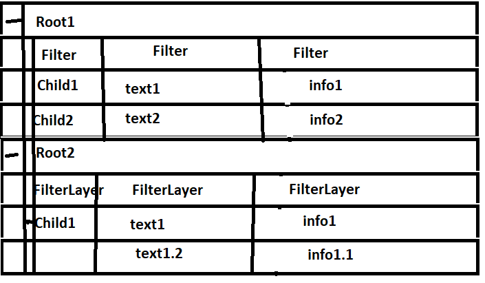

I am very new to Nattable. I have to design table like below.
In treeLayer each root has some data and another treelayer inside root. I have to configure filterLayer to inside treeLayer. So there will be muliple root and each root has sub/another treeLayer. I want to add filterLayer above to inside treeLayer.
Looking some tips or anyother better approach then natTable.
Thank you :)

Re: FilterLayer [message #1831175 is a reply to message #1831172] Wed, 12 August 2020 23:36 Go to previous message
From my point of view such a design do not make sense. The tree is built up with a single collection. You can't compose multiple TreeLayer for one tree and you can't add multiple FilterLayer inside one NatTable as filtering operates on the whole underlying data structure. IMO this is not possible.
