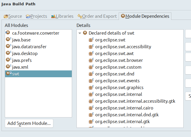

Here's my Java Build Path Libraries and Modules pages:
index.php/fa/38796/0/
index.php/fa/38797/0/
Any ideas? Lots of simple examples out there but nothing that addresses my situation very well.
Craig
Re: Can't run java project with module warning [message #1831487 is a reply to message #1831444] Thu, 20 August 2020 11:53 Go to previous message
Got it working! I'm on linux so my --module-path delimiter should have been : not ;
