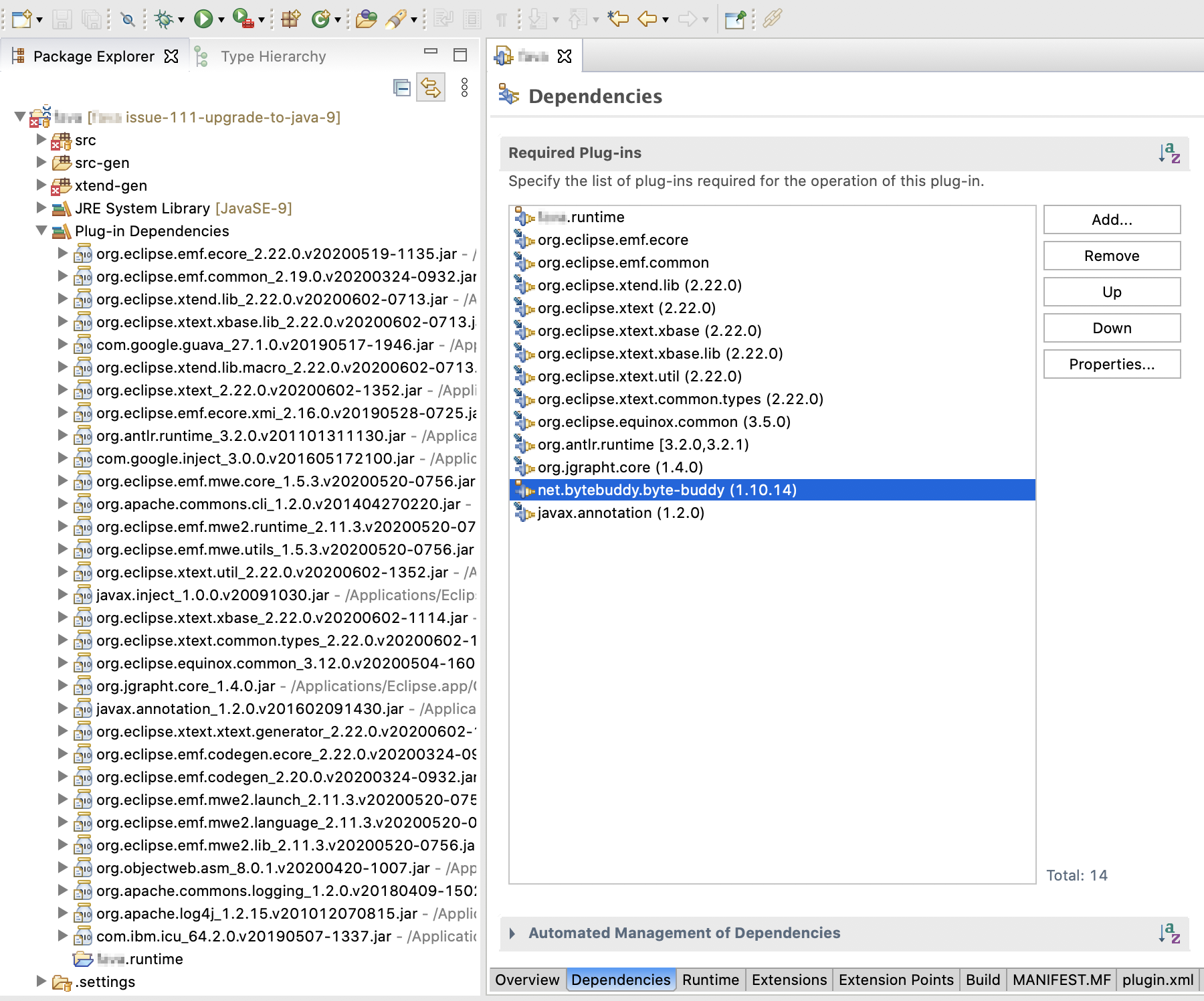

I'm in the process of upgrading a large project from Java 8 to Java 9, and I've finally succeeded to get everything to build via Maven, but now my Eclipse workbench has all kinds of problems. Specifically, there is a very fundamental dependency that is (and always was) listed in the MANIFEST.MF, but now, all of a sudden, this dependency is no longer reflected in the Plug-in Dependencies classpath container, and the workbench has hundreds of compilation problems due to that missing dependency:
index.php/fa/38758/0/
net.bytebuddy.byte-buddy, version 1.10.14 is installed into the platform from a local update site (generated by a Maven build), but for some reason it does not make it to the classpath. I also noticed that the icon is somewhat different from the other dependencies (yellow ball overlay), and the only other dependency with that same icon is a dependency on another bundle in the workspace (the .runtime bundle whose full name is redacted in the screen shot). There are other dependencies that come from the same local update site (e.g., org.jgrapht.core), and those have the same regular icon as all the other dependencies.
The MANIFEST.MF lists the dependency in the regular manner, i.e.
 org.jgrapht.core;bundle-version="1.4.0",
 net.bytebuddy.byte-buddy;bundle-version="1.10.14",
 javax.annotation;bundle-version="1.2.0"
Bundle-RequiredExecutionEnvironment: JavaSE-9
and I also checked the manifest of the Byte Buddy dependency itself, and it appears to be well-formed and it exports all the necessary packages.
Has anybody else seen this scenario (i.e., dependencies from the manifest don't make it into the classpath)? What other diagnostics can I run to track down what happens with the problematic dependency?
Re: Dependency from MANIFEST.MF does not show up in Plug-in Dependencies classpath container [message #1831026 is a reply to message #1831022] Mon, 10 August 2020 02:47 Go to previous messageGo to next message
This is more a PDE question than an Equinox question.
One thing I would check is the contents of the .classpath file for that project. The question is whether the .classpath is in sync with the BREE in the MANIFEST.MF, as should be the case after you invoke Plug-in Tools -> Update Classpath... from the context menu of the project I'm not sure if that could cause this problem, but it's worth checking.
It's strange that it shows the plugin without a red x indicating that it's resolved, but it doesn't show up in the classpath. Does double clicking on it open it?
Another place to see this information is from the context menu of the project Properties -> Java Build Path and then the Libraries tab. Here the icons should show if it's a jar, a folder, or something int he workspace.

Re: Dependency from MANIFEST.MF does not show up in Plug-in Dependencies classpath container [message #1831054 is a reply to message #1831026] Mon, 10 August 2020 19:34 Go to previous messageGo to next message
Thanks for your quick response, Ed! I ran Plug-in Tools ▸ Update Classpath..., and the only change to the .classpath file was in the order of the elements (the update moved the source folders to the bottom):

At any rate, this appears to be in line with the BREE from the manifest:
Double-clicking the problematic dependency indeed opens the manifest editor, and the manifest seems to be alright:

The dependency does not show up in Properties ▸ Java Build Path either.

Never mind... I finally solved this mystery after double-clicking the dependency bundle in the manifest editor and the enabling the Link with Editor option in the Package Explorer.
It turns out that, at some point, I had extracted the bundle's manifest via jar xf bytebuddy.jar META-INF/MANIFEST.MF. I happened to do this while I was in the folder of an unrelated project in my workspace, so the manifest showed up in my workspace.
The interesting thing is that this project was not a plug-in project or even a Java project (it was the Maven parent project of some other unrelated modules). This project has only the Maven nature associated with it, so I am surprised that the MANIFEST.MF file got picked up by PDE.
So, long story short, if anyone runs into a similar issue check your workspace for rogue MANIFEST.MF files.
I'm not sure if this is a PDE bug, but apparently this rogue manifest was able to displace the real manifest just because it happened to be called MANIFEST.MF and was located in a META-INF folder. I am a little baffled that this gets picked up even from non-plugin projects.
