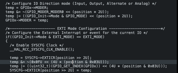

So I'm not sure if it has to do with the version of the eclipse that I'm using but some files are totally greyed out (no syntax coloring) and can't even get to the definition of a certain variable/function by hovering over it while pressing CMD key (mac), which is super annoying.
Does anyone know what might be wrong?

Are the greyed-out files excluded from the current build configuration?
https://mcuoneclipse.com/2014/07/22/exclude-source-files-from-build-in-eclipse/
Re: Why some of my source files are greyed out [message #1832044 is a reply to message #1831520] Mon, 07 September 2020 07:22 Go to previous messageGo to next message
the grey out file means the file is excluded from the build.
Re: Why some of my source files are greyed out [message #1832178 is a reply to message #1832044] Thu, 10 September 2020 21:42 Go to previous messageGo to next message
That means the file is excluded from the build.
Re: Why some of my source files are greyed out [message #1833197 is a reply to message #1832178] Tue, 06 October 2020 07:58 Go to previous message
The greyed/striked out file means the file is excluded from the build.
