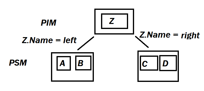

Dear All,
I am trying to transform the instances of Z to either to the instances at left or right.
If the Z's Name attribute is entered as 'left' then the rules that belong to left must be run to convert Z to both A and B. If 'right' then the rules that belong to the right must be run to C and D.
Thanks for your help.
  • Attachment: question.png
    (Size: 13.48KB, Downloaded 122 times)
Re: How to certain rules with entered paramter to an Attribute? [message #1831145 is a reply to message #1830651] Wed, 12 August 2020 07:04 Go to previous messageGo to next message
rule ZLeft {
  from s : PIM!Z (s.name = 'left')
  to a : PSM!A (
     b : PSM!B (
rule ZRight {
  from s : PSM!Z (s.name = 'right')
  to c : PSM!C (
     d : PSM!D (
Re: How to certain rules with entered paramter to an Attribute? [message #1831155 is a reply to message #1831145] Wed, 12 August 2020 09:51 Go to previous message
Thanks Dennis, I managed it to work !
