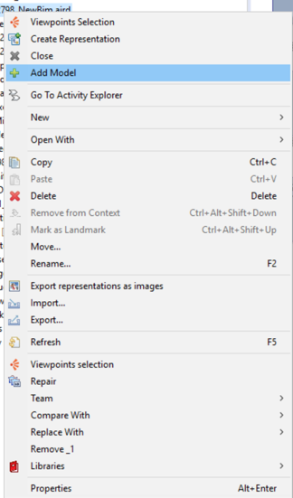

Re: Reuse components of one model in another model [message #1830639 is a reply to message #1830609] Thu, 30 July 2020 05:25 Go to previous messageGo to next message
Thank you.
In the Model Eplorer view, It's possible to add a reference from one model to another (cf. capture)
This work fine, but it's not possible to add links between this two model.
  • Attachment: addModel.png
    (Size: 70.38KB, Downloaded 129 times)
Re: Reuse components of one model in another model [message #1830664 is a reply to message #1830639] Thu, 30 July 2020 13:21 Go to previous messageGo to next message
I think you should avoid using the Model Explorer view with Capella and stick to the Capella perspective which uses the Project Explorer view, in this one you can't add a model as you do.
I mean, what you are trying to do may be working, but in any case, if your goal is to do resue between Capella models, you should use REC/RPL and librarires.
