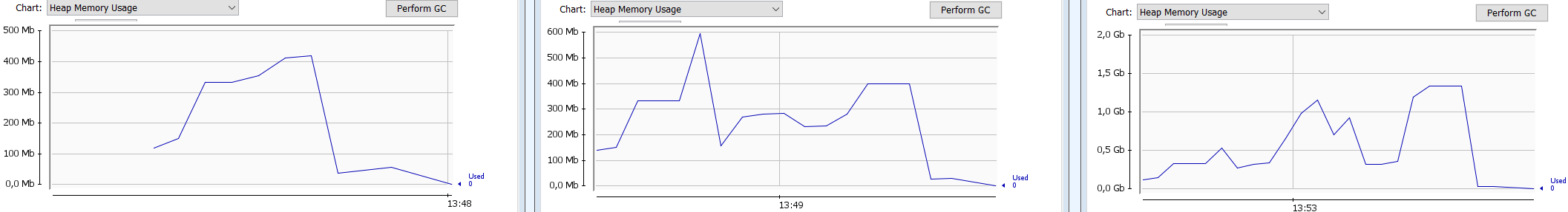

We want to integrate Viatra in an already existing software. As our source and target model are quiet big, we don't want to spend lots of memory for Viatra on top of that. For example: Both models can contain around 50 000 instances of some model elements. So we have multiple queries with large amount of matches.
If you're interested, I have attached some measurements right below with a typical model and typical queries for our project. The scaling is different for the different diagrams.
For the used model two queries exist with 100 000 matches (among others).
On the left you see the memory consumption when loading our source model into the memory, waiting a bit and then unloading it.
In the middle the same model is loaded and an advanced viatra query engine with our queries and IMatchUpdateListeners is created. After some time engine and model are unloaded.
On the right the viatra query engine is used with an EVM and corresponding jobs to our queries instead of IMatchUpdateListeners.
Neither the listeners nor the jobs perform any action.
Especially when initializing the engine or when performing lots of model changes the Listeners seemed to have less and smaller peaks in the memory consumption.
Nadine
Re: Disadvantages of IMatchUpdateListener [message #1830519 is a reply to message #1830514] Tue, 28 July 2020 06:38 Go to previous messageGo to next message
Hey,
I am pretty sure what you are measuring here is total heap consumption at any given moment. In addition to the actual memory footprint of the Java program (strongly reachable objects), it also includes unreachable objects (garbage) which are temporary heap objects that are no longer needed and have simply not been cleaned up by the Garbage Collector (GC) yet. While a large volume of garbage objects do have a negative impact on performance in a roundabout way (slightly increasing the cost of GC), but it is misleading to think of the program as requiring that much excess memory.
A more reliable way of measuring memory is to use a profiler to take a memory dump of the Java VM, and compute the strongly reachable size according to this dump. Or, if you use such a live chart, at least hit "Perform GC" in the steady state to see how much of the heap is actually strongly reachable. There is a segment in your third figure that suggests a fairly moderate heap size, around 3-400 MB (but I do not know whether everything was already loaded here).

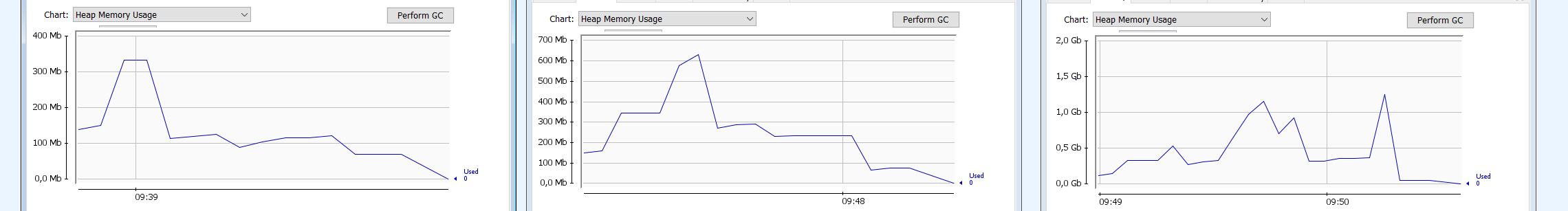

I forgot to mention it: the garbage collector was explicitly called after the initialization of the engines and after disposing. Without that, the diagram for the EVM looks worse (then you wouldn't see the segment where it stays at 3-400MB).
So perhaps the memory consumption is pretty equal, when the engine is initialized and only some small changes are made. But before that or when working with the model extensively the differences are visible. I attached another example (like before: left: without Viatra, middle: with Listeners, right: with EVM).
The scenario for this example was:
- Load Model
- Initialize Engine (if used)
- Garbage Collector
- Delete 10 000 entities (which are part of multiple matches of different queries)
- Dispose engine
- Garbage Collector
This is perhaps not the most common use case, but we wanted to know, how Viatra would react in such cases. Even if these are just temporarly peaks in memory consumption, it's interessting to see those differences.
