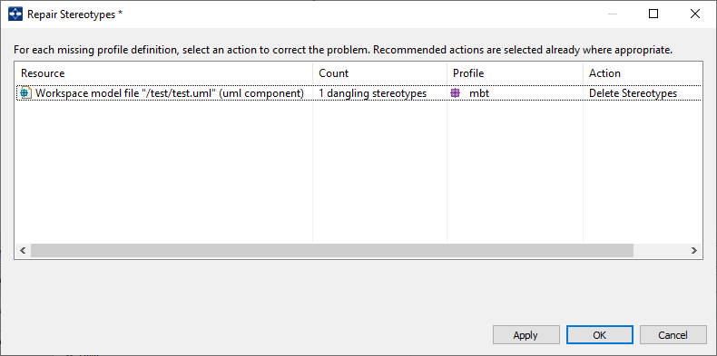

Since recently, whenever I delete a stereotyped element from my diagram, close Papyrus and later reopen the diagram, I get this message that I have dangling stereotypes for the elements I deleted before.
Can anyone explain this phenomenon?
I have my own architecture context with a static profile. I think that before this happened for the first time, I made some changes in my profile and regenerated the static profile, but I also changed a couple of other things in the .elementtypesconfigurations and architecture context which I don't quite remember.
Could it be that there is something wrong in my .elementtypesconfigurations? Or maybe I did something wrong when I regenerated my static profile?
