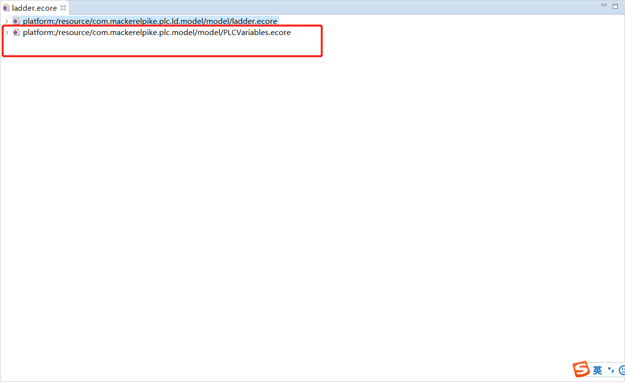

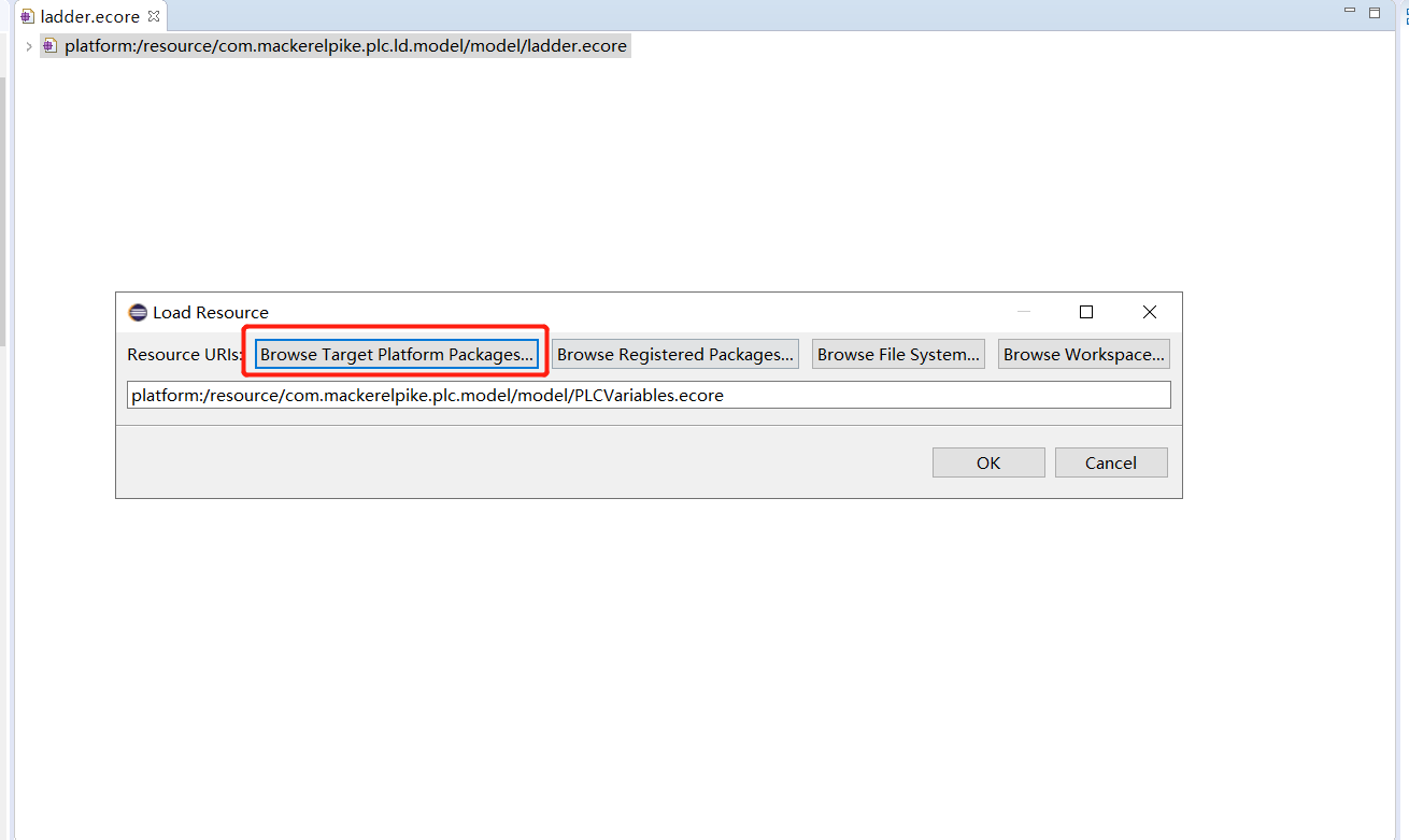

In Ecore Model Editor of ladder.ecore , I loaded PLCVariables.ecore.
index.php/fa/38629/0/
index.php/fa/38630/0/
Then I created an EClass xxx for ladder.ecore, and created an EReference for xxx and refered an EClass yyy of PLCVariables.ecore.

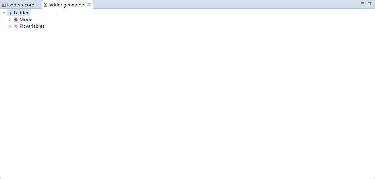

I open ladder.gemodel in EMF Generator Editor. The plcvariables was shown under Ladder.

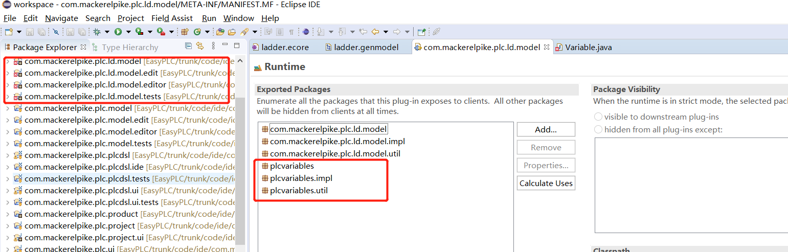

After genreating the code, The eclipse show me errors.
index.php/fa/38634/0/
The EMF added packages of plcvariables.ecore into "Runtime" . But there was no package of plcvariables.ecore in ladder.model's project.
My question is : How can I avoid those errors? I generated code of plcvariables.ecore in plcvariables.ecore's project, I added those generated packages of plcvaraibles.ecore into "dependencies" of ladder.ecore's project.How can I disable emf add pakcages of refered plcvariables.ecore automatically? I do not need those packages in ladder.ecore's project.

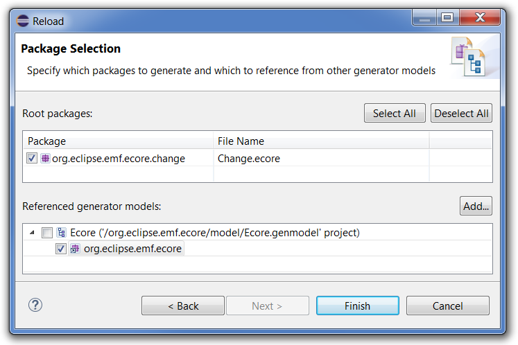

In your 3.png I can see that Ladder.genmodel has two GenPackages, Model and Plcvariables. That means this GenModel will generate and expects to generate all the code and infrastructure for two GenPackages. But that's not what you want because you already have a project where you've generated all the code/infrastructure for Plcvariables. So this Ladder.genmodel should contain only one genPackage element like this one:
https://git.eclipse.org/c/emf/org.eclipse.emf.git/tree/plugins/org.eclipse.emf.ecore.change/model/Change.genmodel#n12
But yours contains two of them. Instead the Pclvariables GenPackage should be referenced as a usedGenPackage like this:
https://git.eclipse.org/c/emf/org.eclipse.emf.git/tree/plugins/org.eclipse.emf.ecore.change/model/Change.genmodel#n7
To achieve that you should Reload.. the GenModel either from the Generator menubar or from the context menu of the *.genmodel resource and make sure the final page looks like this:
index.php/fa/38635/0/
