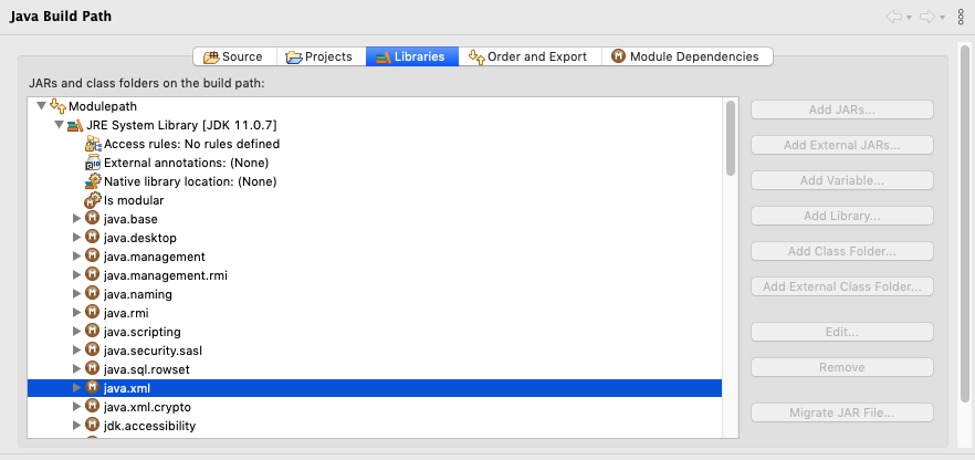

I'm new using Eclipse for Java EE (4.15.0) + Maven + Java 11, I'm trying to implement a modular project for the 1st time.
I'm trying to run a simple JUnit test and I'm getting the following error:
java.lang.module.ResolutionException: Modules javaee.api and java.xml export package javax.xml.stream.util to module org.mockito
javaee.api module was indeed declared in my module-info.java and declared in my pom.xml. But I didn't declare java.xml. Apparently it comes from JRE System Library in the module path from the Java Build Path as shown in the attached screenshot.
What I'm supposed to do in this case? Should I generate a custom JRE without java.xml so I can use in this workspace? Or can eclipse automatically do that for me?
