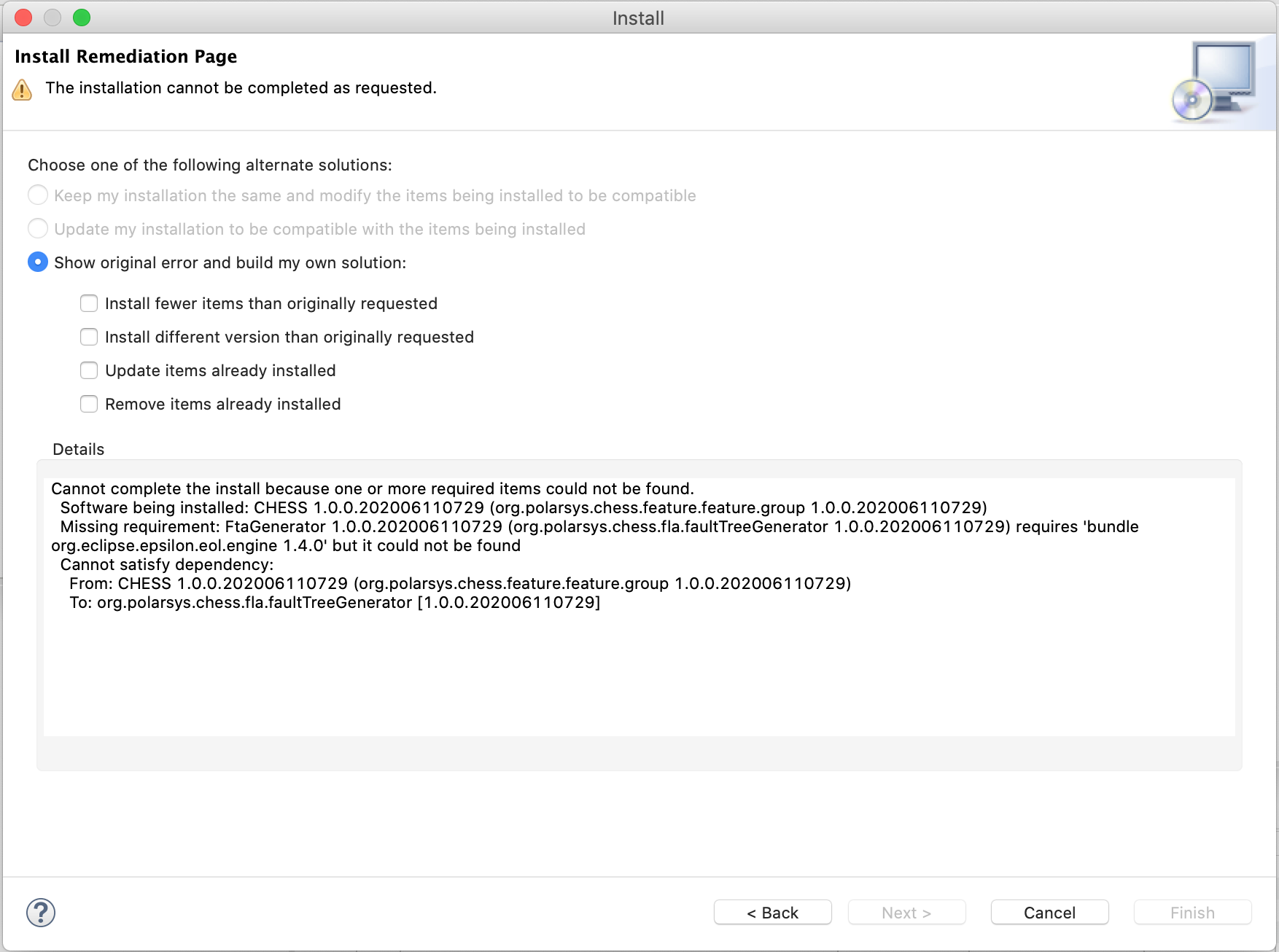

Dear all,
I am trying to install CHESS on my laptop by following the guidelines at the following link: https://www.eclipse.org/chess/start.html . Everything proceeds smoothly until I reach the installation of CHESS itself. When I add the update site and select the CHESS feature I get an error due to a missing dependency (see the screenshot attached). I guess the problem is the missing installation of Epsilon, since EOL is missing. In this respect I tried to install Epsilon from their update site but the installation fails.
For your convenience, I am running on a Mac OSX 10.15.5.
Thanks for any possible help,
Antonio

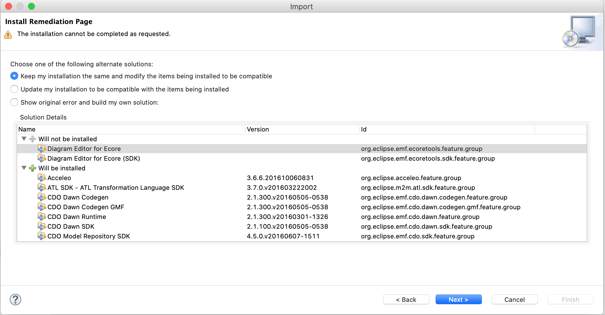

Re: CHESS 1.0.0 installation problem [message #1832653 is a reply to message #1832618] Tue, 22 September 2020 14:53 Go to previous messageGo to next message
Hi again Alberto,
unfortunately I still have several issues when I try to install CHESS. First I have got an incompatibility problem when importing the CHESS.p2f file, where apparently 2 components already exist in the installation in a newer version (I attach a screenshot of that problem). Everything else worked flawlessly until I tried to install CHESS from the update site (please note that in the guide there are 2 different links to the site). In this case the installation fails with a problem due to missing components. Also in this case I am attaching a screenshot.
Thanks again for the support,
Antonio
Re: CHESS 1.0.0 installation problem [message #1832667 is a reply to message #1832653] Wed, 23 September 2020 03:18 Go to previous messageGo to next message
Did you start the procedure from scratch, from the eclipse-modeling-neon-3?
Compared to the previous version of the the CHESS.p2f, I've only added a missing dependency. You should have had the same problem on the first try too. Am I wrong?
Did you uncheck "Install latest version of selected software"?
You should use the new links in the guide to the update-sites. Could you please attach the the error related to the new update sites?

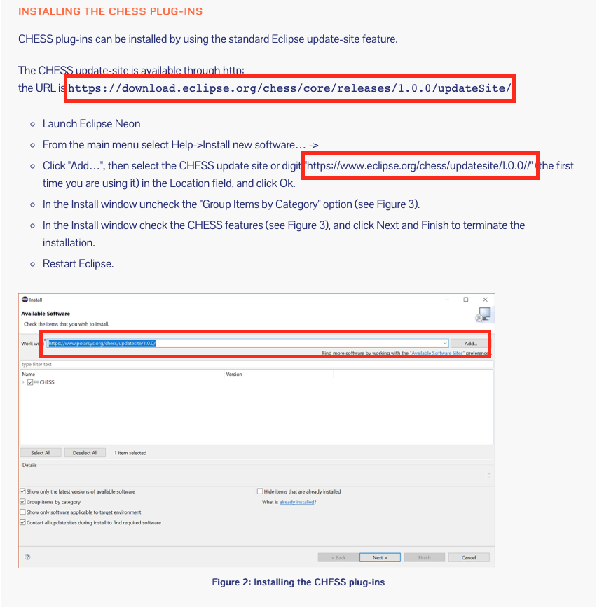

Re: CHESS 1.0.0 installation problem [message #1832680 is a reply to message #1832667] Wed, 23 September 2020 05:26 Go to previous messageGo to next message
Dear Alberto,
I re-did the installation from scratch again, just to be sure. For the first problem it is my fault, I did it so many times that I jumped the step of removing ECore Diagram Editor and removed only Parsley. So the only pending issue now is with CHESS plugins installation. I am attaching the description on the CHESS page (https://www.eclipse.org/chess/start.html) and I marked the 3 different links one could see for the update site. I am using the first one, and when I try to install CHESS I get the problem as shown in the other screenshot I am attaching.
Antonio
Re: CHESS 1.0.0 installation problem [message #1832687 is a reply to message #1832680] Wed, 23 September 2020 07:38 Go to previous messageGo to next message
I updated the CHESS.e2f file with the missing dependency. I tested the entire procedure and it works to me.
I think you could re-import the CHESS.e2f without starting from the beginning of the procedure. Remember to uncheck "Install latest version of selected software".
I've also updated the references to the CHESS update-sites (thanks for the tip).

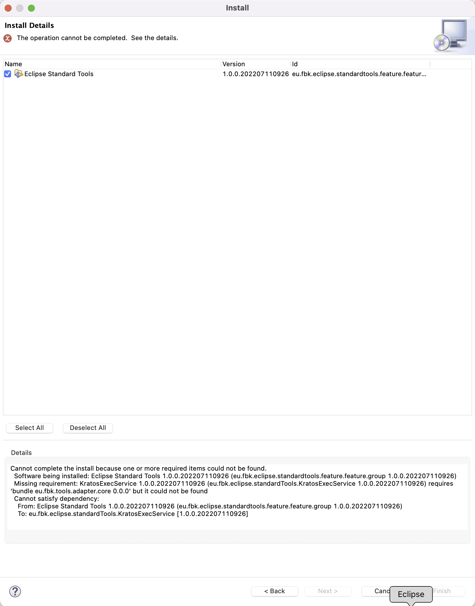

Re: CHESS 1.0.0 installation problem [message #1854114 is a reply to message #1832690] Mon, 01 August 2022 14:11 Go to previous messageGo to next message
Hi Alberto.
I'm also attempting to install CHESS on my Mac, but I'm having trouble with the EST installation dependencies.
Cannot complete the install because one or more required items could not be found.
Software being installed: Eclipse Standard Tools 1.0.0.202207110926 (eu.fbk.eclipse.standardtools.feature.feature.group 1.0.0.202207110926)
Missing requirement: KratosExecService 1.0.0.202207110926 (eu.fbk.eclipse.standardTools.KratosExecService 1.0.0.202207110926) requires 'bundle eu.fbk.tools.adapter.core 0.0.0' but it could not be found
Cannot satisfy dependency:
From: Eclipse Standard Tools 1.0.0.202207110926 (eu.fbk.eclipse.standardtools.feature.feature.group 1.0.0.202207110926)
To: eu.fbk.eclipse.standardTools.KratosExecService [1.0.0.202207110926]
I've attached the screenshot for your reference.
Any help?
Felicien
Re: CHESS 1.0.0 installation problem [message #1854124 is a reply to message #1854114] Tue, 02 August 2022 04:11 Go to previous messageGo to next message
Hi Felicien,
I've just updated the https://www.eclipse.org/chess/start.html page.
The following update-sites:
http://es-static.fbk.eu/tools/eclipse_sde/
http://es-static.fbk.eu/tools/eclipse_est/
should be replaced with:
http://es-static.fbk.eu/tools/eclipse/eata/
http://es-static.fbk.eu/tools/eclipse/sde/
http://es-static.fbk.eu/tools/eclipse/est/

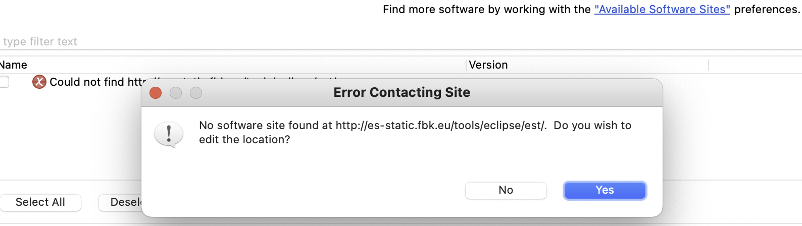

Hello Alberto,
I did follow your guidance, but on all the links provided, it appear to have no software deployed. Could you please double-check on them again?
I'm getting the errors shown in the attached image. I also tried to check with other eclipses I had, but the issue remains.
Thank you.

Re: CHESS 1.0.0 installation problem [message #1854129 is a reply to message #1854128] Tue, 02 August 2022 11:11 Go to previous messageGo to next message
My mistake. I meant:
http://es-static.fbk.eu/tools/eclipse/neon/eata/
http://es-static.fbk.eu/tools/eclipse/neon/sde/
http://es-static.fbk.eu/tools/eclipse/neon/est/
