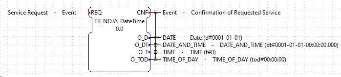

Date/Time
The Date Time function block can represent current system date and time in 4DIAC data types.
The Date Time function block is subject to clock change by NTP, Daylight Savings Time, user or other updates. Where a monotonic time is required, refer to Monotonic Time function block.
index.php/fa/38589/0/

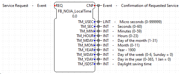

Local Time
The Local Time function block can represent current system date and time in broken down time components.
The Local Time function block is subject to clock change by NTP, Daylight Savings Time, user or other updates. Where a monotonic time is required, refer to Monotonic Time function block.
index.php/fa/38590/0/

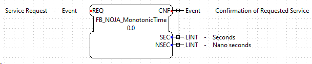

Monotonic Time
Monotonic time can be described as:
  • Clock that cannot be set and represents monotonic time since some unspecified starting point.
  • A monotonic clock is a time source that will never jump forward or backward (due to NTP, Daylight Savings Time, user or other updates).
index.php/fa/38591/0/

The idea of all these different time based data types are the use cases you mentioned. You can get the current date and time via the NOW function, returning a DATE_AND_TIME which can be explicitly cast into other data types which represent dates, i.e. DATE and TIME_OF_DAY
The TIME data type is not a specific date, but a time span, so the NOW_MONOTONIC returns a TIME with the time span since the starting point for the monotonic time start.
This also leads to a problem with your first FB_NOJA_DateTime, which returns a DATE, DATE_AND_TIME, TIME_OF_DAY, and TIME. The TIME type is incompatible with the other ones as it is a time span. Also, the other outputs can be generated via DT_TO_XXX cast FBs, so no need for providing all of them. As far as I see, it seems that no cast FBs are available right now, but can be easily created by wrapping a cast operator into a FB.
So if you are in need for such an FB, the best solution from my point of view would be to wrap the NOW function into an FB with a single DATE_AND_TIME output.
For monotonic time you can wrap the NOW_MONOTONIC function into an FB with a single TIME output (which replaces your third FB).
For your second FB, I do not see a use case, as you can compare two DATE_AND_TIME, DATE, and TIME_OF_DAY and you can also calculate the differences between dates, and most of the other information is included in the output of NOW or can easily calculated from it.
