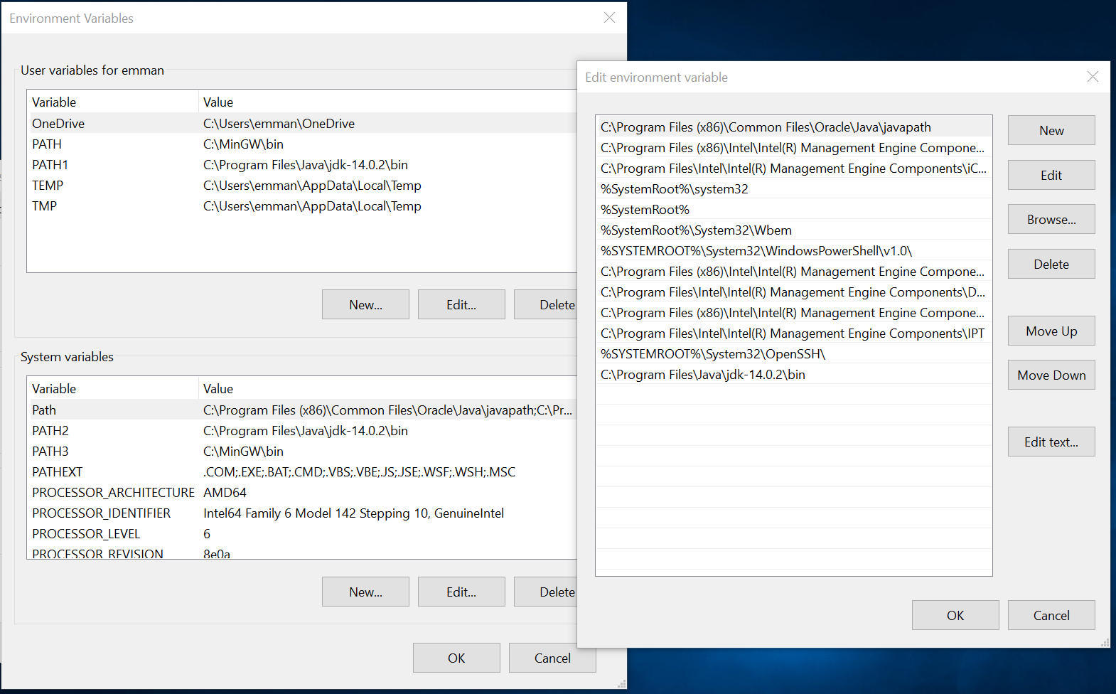

I have paths made
[paths][1]

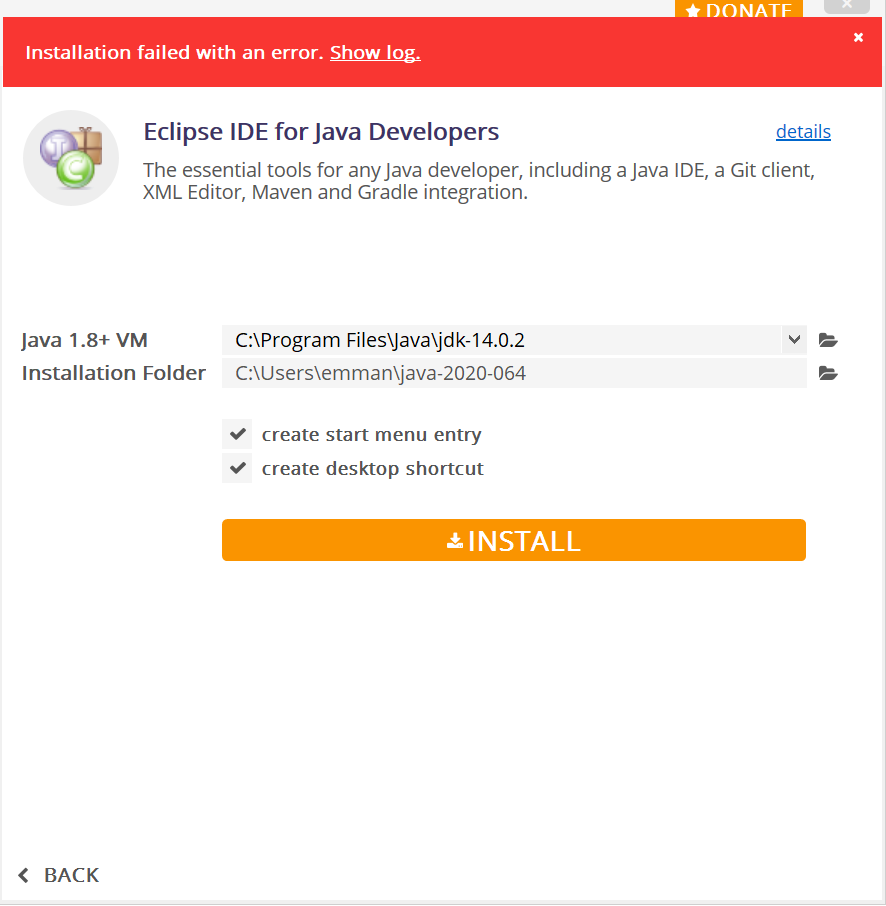

[Eclipse Installation Folders][2]
installation log:

  • Attachment: paths.png
    (Size: 135.42KB, Downloaded 131 times)
  • Attachment: error.png
    (Size: 48.67KB, Downloaded 119 times)
Re: Why an error downloading Eclipse 2020-06.? [message #1830031 is a reply to message #1830012] Thu, 16 July 2020 00:22 Go to previous message
Does it fail the same way on a subsequent attempt? I assume this file really does not exist on your system.
C:\Users\emman\.p2\pool\features\org.eclipse.userstorage_1.2.0.v20191120-1614
If it fails the same way repeatedly, trying repairing the pool as described here:
https://www.eclipse.org/setups/installer/question/
I.e., Use the eclipse installer's Bundle Pools... menu item to manage where this pool is physically located on disk; this location can become large. The Bundle Pool Management dialog supports garbage collecting of unused artifacts, i.e., if you delete an installation, the artifacts it uses can potentially be removed from disk. In addition, if some artifact becomes corrupted, or if a corrupted artifact is downloaded from some mirror site, this dialog can be used to detect the damage and to repair it.
Note that problems like this can be caused by your virus scanner:
https://bugs.eclipse.org/bugs/show_bug.cgi?id=548443#c42
The virus scanner can also make Eclipse run very slow, so you might want to look at the details of that bug to disable the virus scan from scanning your .p2 folder and your .eclipse folder (in your home folder).
