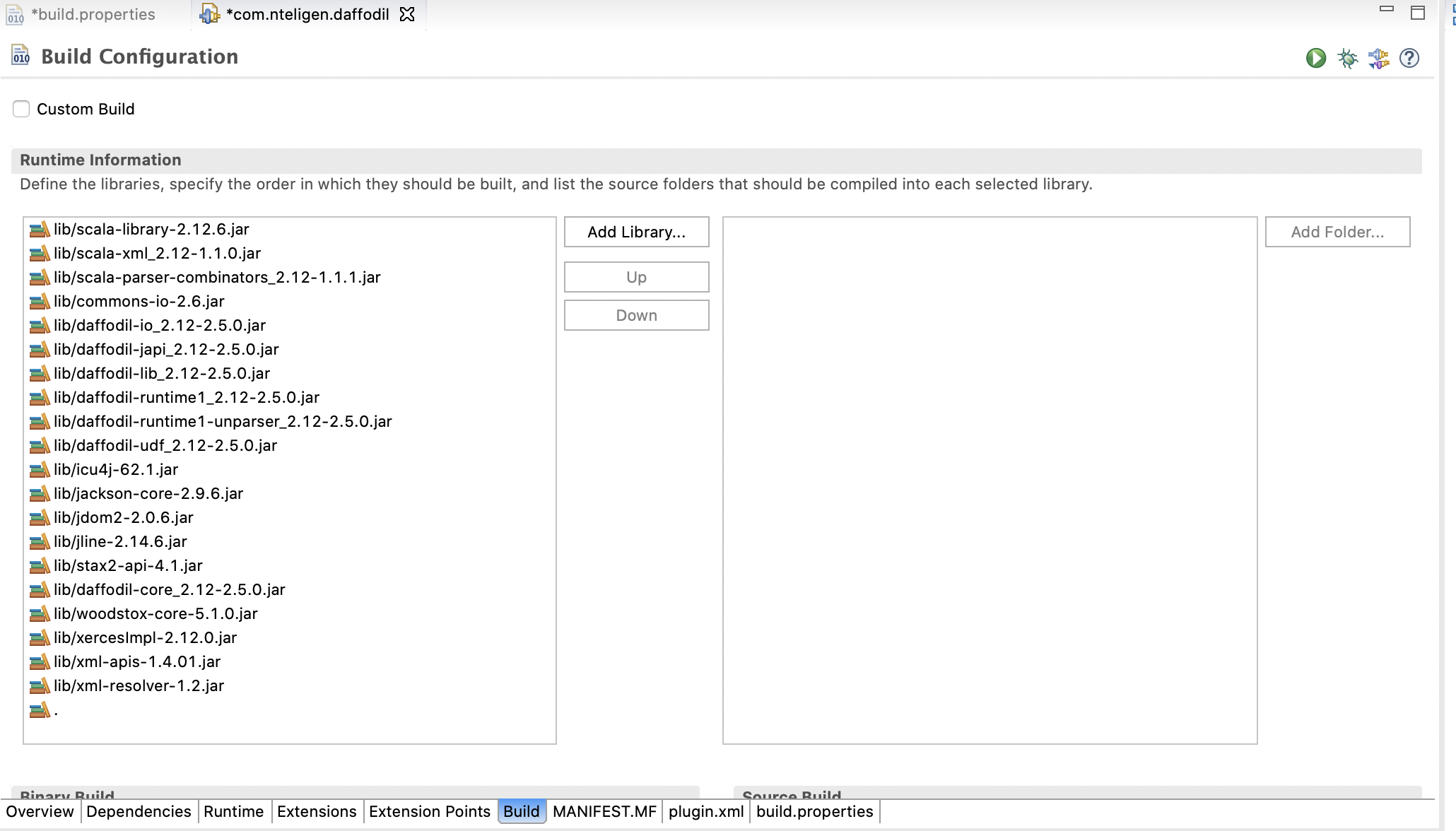

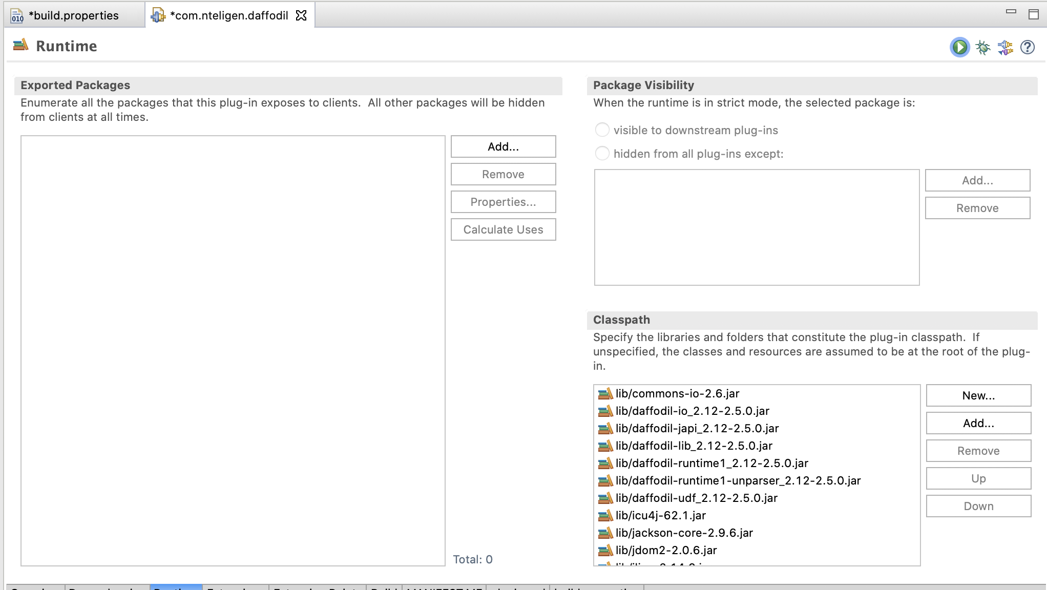

I have the jars included in the runtime and build tabs of the plugin manifest (see attached photos). So, if I am understanding you correctly, I need to remove all of the sections about the jar sources, and just include the source folder for the source code? Do I remove the section about the jars.compile.order? The build.properties tab is currently in the format automatically created when you include jars in the runtime and build tabs.
Re: How to format build.properities for eclipse plugin export [message #1830084 is a reply to message #1830062] Fri, 17 July 2020 02:43 Go to previous message
I'm not sure the impact of the compile order property in this case. Certainly it seems likely the source needs to see the jars to compile. I suppose you need to poke at it until it doesn't fail during the export...
