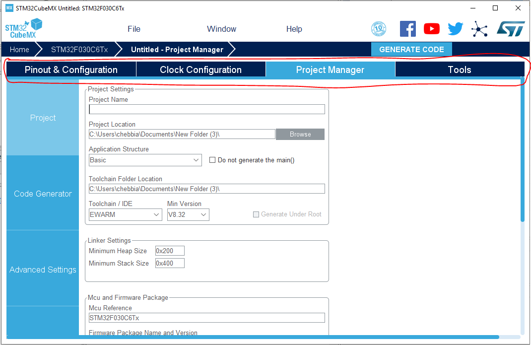

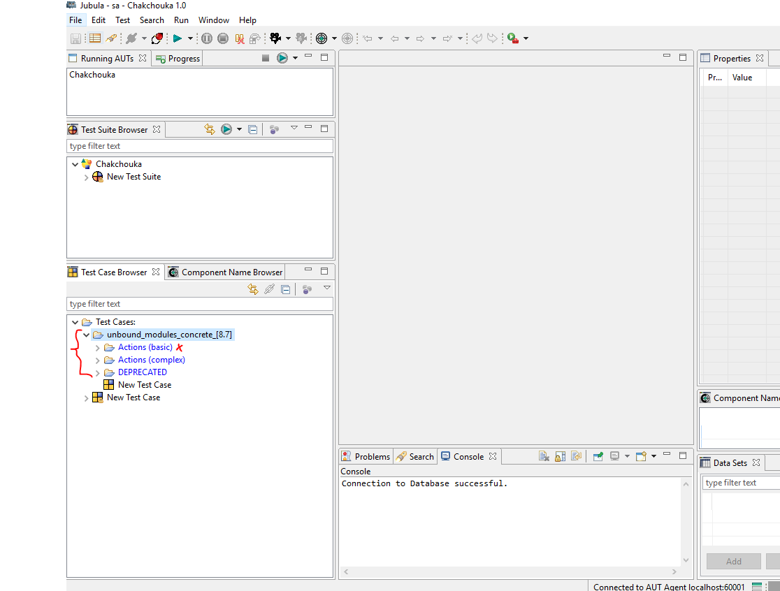

My project is about creating automatic tests under Jubula Version: 8.7.1.046 my AUT cubeMX
in my scenario i want to map an object :Tabbed Pane but the problem is that Jublua can't recognize this object , my idea is to develop a Toolkit for creating new action to recognize this object so i wanna know after developing this toolkit with this method : Creating toolkit extensions using the Extension Wizard how i implements the Toolkit into ITE Jubula for creating my new action which i will use to map the TAbbed Pane(something like Action under Unbound_modules_concrete)

Tabbed Panes in Swing, JavaFX or SWT should be supported. If this is a special kind of Tabbed Panes, you need the exact class name of it.
This is where the the work begins to find out which class is used and how you can support it as a Tabbed Pane. The easiest solution would be to just only write an adapter for ITabbedComponent an implement the adapter factory.
The ComponentConfiguration xml would than use the TabPaneTester from the toolkit you want to use.
The benefit would be that you can reuse the existing tabbed pane actions.
If you want to write it all by youreself with your own tester class.
You can write your own Test cases and use the new actions you have created via the Componentconfiguration.
