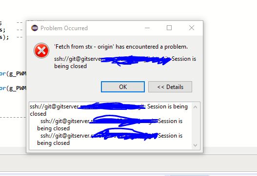

I cloned my respositories from Bitbucket in my local (windows 10), and I already generated a private SSH with Eclipse and copied in my Bitbucket profile, but when I tried to fetch I received an error.
index.php/fa/38561/0/
Is there any solution?

No idea. Make sure you have EGit 5.8.0 installed. It might also be a bug in bitbucket; compare https://www.eclipse.org/forums/index.php?t=msg&th=1104150&goto=1829735&#msg_1829735, which was found to be a bitbucket problem. If it's a timeout problem, try increasing the remote connection timeout under Preferences->Team->Git.

I am using the last version , I found the EGit in Linux machine works fine but on Windows is faced a problem. Is there any special configuration fro Windows?

Apart from setting %HOME%, no; should work exactly as it does on Linux. (SSH config files under %HOME%\.ssh) Simply increasing the remote connection timeout doesn't help?
Re: Error in in respositories from Bitbucket [message #1830092 is a reply to message #1829902] Fri, 17 July 2020 04:04 Go to previous message
Ask the Bitbucket admins if they find additional details in the server side logs.
Try to fetch over https.
