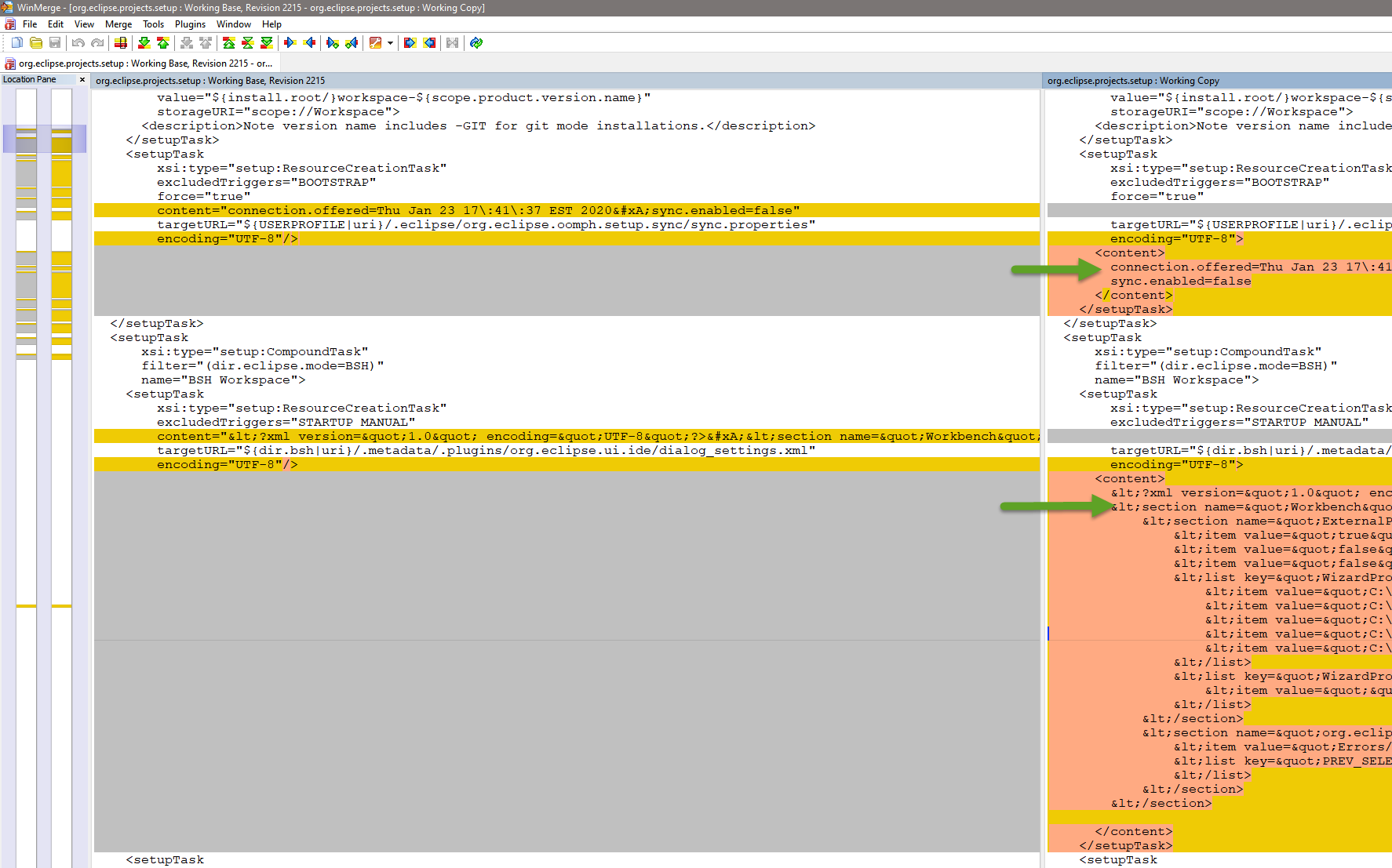

Unfortunately it is. When it converts the contents down to the tag it also tries to format the contents (sorry I didn't use code tag on the first post). I'll fire up my test box again and do a clean install so I can figure out exactly what was breaking and report back.
    <setupTask
        xsi:type="setup:ResourceCreationTask"
        excludedTriggers="BOOTSTRAP"
        force="true"
        targetURL="${USERPROFILE|uri}/.eclipse/org.eclipse.oomph.setup.sync/sync.properties"
        encoding="UTF-8">
      <content>
        connection.offered=Thu Jan 23 17\:41\:37 EST 2020
        sync.enabled=false
      </content>
    </setupTask>

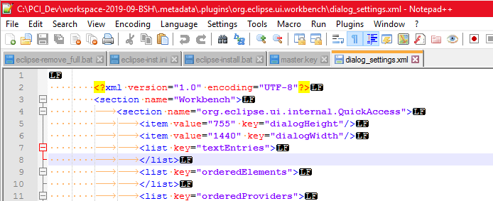

Ok, I found a good example. This is where I am defaulting some dialog options and it works fine until I let the newer Oomph editor redo the content data. In the new version the file gets generated with an extra blank line and everything is offset:
        <section name="Workbench">
        	<section name="org.eclipse.ui.internal.QuickAccess">
        		<item value="755" key="dialogHeight"/>
        		<item value="1440" key="dialogWidth"/>
The attached image shows the file a little more clearly.

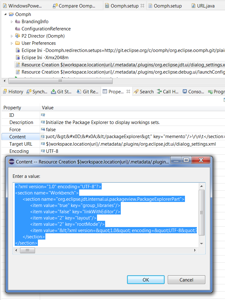

In Oomph we have a task to create the create JDT's dialog_settings.xml as well:
https://git.eclipse.org/c/oomph/org.eclipse.oomph.git/tree/setups/Oomph.setup#n195
And it creates proper results when I test it again just now.
I can also see that the value is correctly deserialized in the Properties view:
index.php/fa/38581/0/
The deserialization is done here:
https://git.eclipse.org/c/oomph/org.eclipse.oomph.git/tree/plugins/org.eclipse.oomph.base/src/org/eclipse/oomph/base/util/BaseResourceImpl.java#n146
You can see it computes indentation and strips it. Can I see how your serialized task looks in the *.setup? Perhaps just the trailing line break is missing on the last line of the resource's text and this breaks the indentation computation. In any case, something is not quite right with the serialization of your original value because of course serialization and subsequent deserialization should preserve the text value.

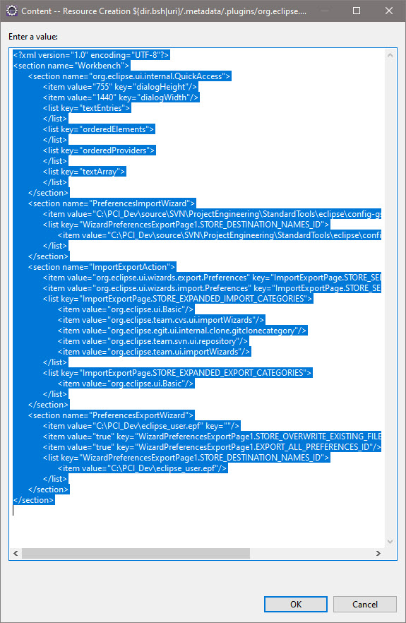

Re: Content in ResourceCreationTask getting mangled on save [message #1830142 is a reply to message #1829921] Fri, 17 July 2020 15:29 Go to previous messageGo to next message
Did you want the content from the older version or newer version?
This is the newer version after it converted and the dialog from the Setup editor for the same content.

Re: Content in ResourceCreationTask getting mangled on save [message #1830152 is a reply to message #1830142] Sat, 18 July 2020 02:09 Go to previous messageGo to next message
That all looks correct to me, and in fact your properties editing dialog shows the value is correct. If I copy the text of both tasks to my workspace.setup, and change them so I can perform them (to not perform only for BOOTSTRAP and the URI to somewhere on my local drive), both produce the expected correct results.
So I'm at a loss to reproduce the problem and for coming up with a theory for why you should see such a problem. Perhaps I'm missing something important between you copying and pasting text to the forum and me copying and pasting them into my setup.
Is it possible to attach a complete *.setup that reproduces the problem?
