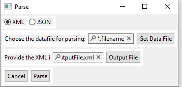

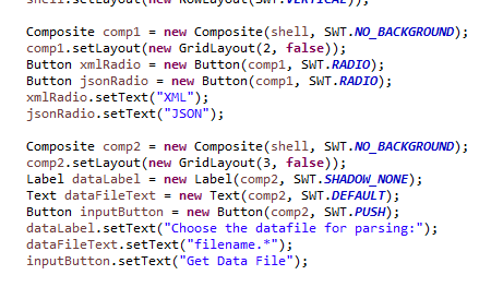

I am developing a custom window using SWT. This window is part of my eclipse PDE plugin. When the window pops up in the runtime version of eclipse, there are white borders around the composites (see attached photo). I thought adding "SWT.NO_BACKGROUND" to the composite would get rid of the issue, but so far it has not.
Any thoughts?
Re: White border around SWT composite Windows [message #1829830 is a reply to message #1829791] Sun, 12 July 2020 01:58 Go to previous messageGo to next message
I think SWT.NO_BACKGROUND is the problem. This make background colorless. Try SWT.NONE.
Re: White border around SWT composite Windows [message #1829948 is a reply to message #1829830] Tue, 14 July 2020 11:47 Go to previous message
That worked! Thank you!
