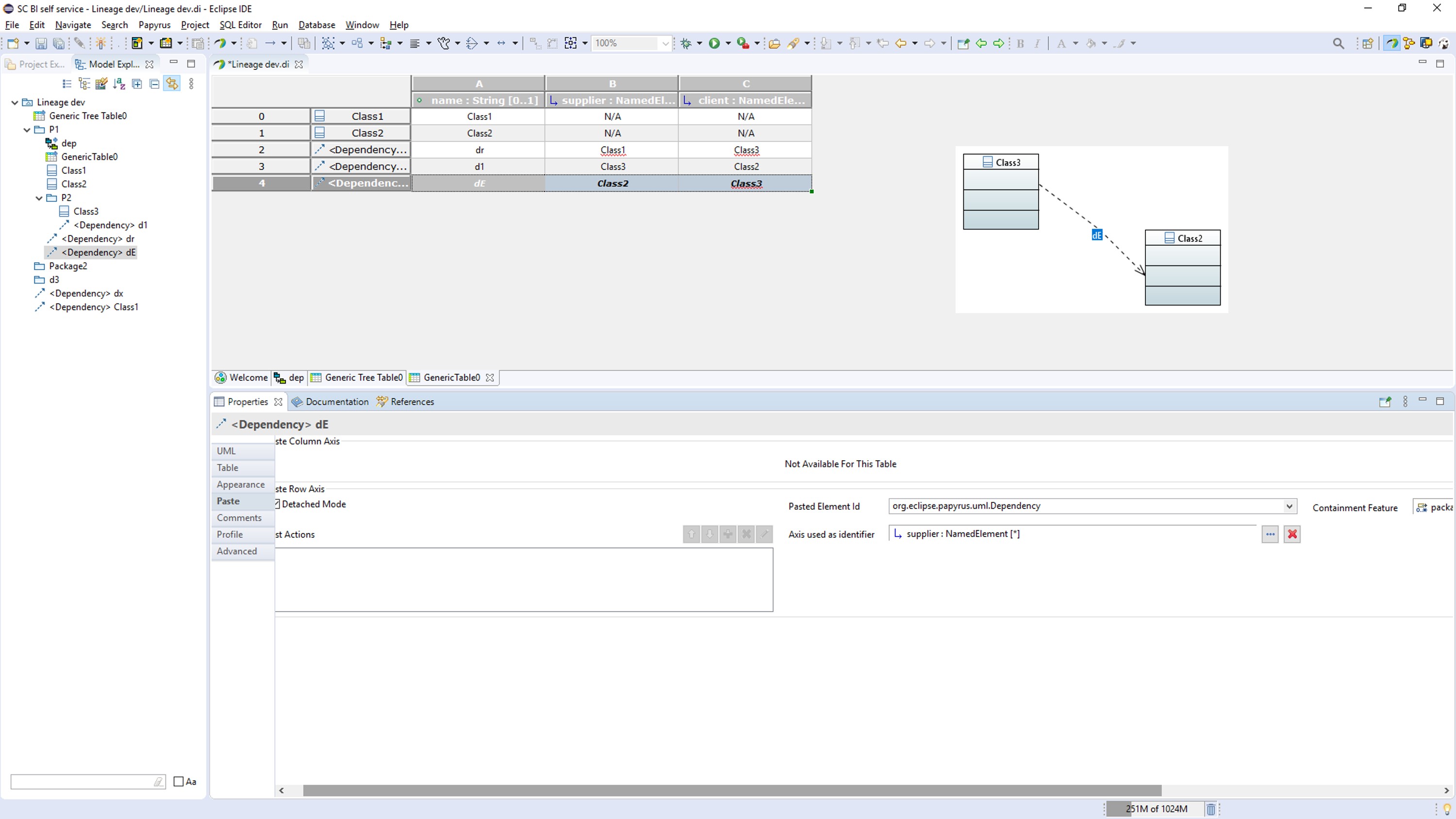

Since my original post I was able to import dependencies in 2 steps: 1) use generic tree table to import packages, classes and attributes 2) use a generic table to import dependencies with each dependency starting from the correct supplier class, and the client class showing correctly in the table but with a resolution error. So I need to double click on each client cell in the generic table and make the mapping of the client class manually, but only for clients. It's progress... If anyone knows how to make this last step automatic (resolving the client class name into the class already present in the model) let me know!
Also, I have not yet tried to have the dependencies import between classes in different packages, I'll report how that goes (anyone has suggestions?)
My import CSV for now looks like this
DependencyName<TAB>SupplierClassName<TAB>ClientClassName<TAB>
Mytable setup looks like this
index.php/fa/38644/0/
  • Attachment: Picture1.jpg
    (Size: 372.62KB, Downloaded 285 times)
