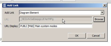

Watching again the Capella Tutorials on youtube I noticed the presenter used links in the Documentation tab of the Activity Explorer to navigate by the elements and diagrams of the level crossing traffic control model. (each link was clickable in Capella and it opened the linked diagram/element.
index.php/fa/38511/0/
I tried to create these links in my models with the link tool in Capella Documentation tab editor but it doesn't seem to work, it does not generate clickable links.
I also tried to import the level crossing traffic control example model from Capella site to check if the links from the presentation were present and the texts that had links on them were all in black (not highlighted as hyperlinks) and not clickable.
Is this feature disabled somehow? If so, how can I enable it?

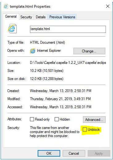

This is a very standard feature of Capella. I can see to things:
- Have a look at this thread: https://polarsys.org/forums/index.php/mv/msg/946/3582/
- And also: You may have to "Unblock" this file: capella\eclipse\plugins\org.eclipse.nebula.widgets.richtext_1.2.0...\org\eclipse\nebula\widgets\richtext\resources\template.html (see the image attached).
Let me know if it fixed your issue.
  • Attachment: unblock.png
    (Size: 142.43KB, Downloaded 223 times)

I checked the file and it doesn't seem to be 'blocked' - I guess that's a feature of a newer version of Windows, I'm still in windows 7 and the 'unblock' checkbox is not available to me in the file properties dialog.
