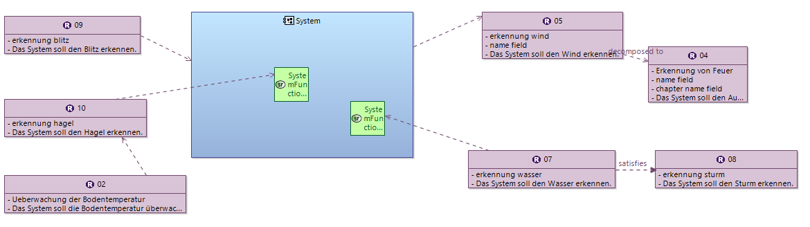

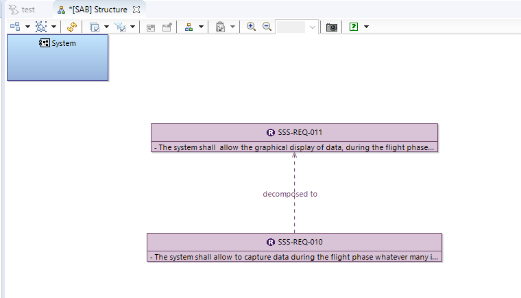

First I imported the reqif-file, than I create a SAB-diagram added the two requirements which are referred as source or target by the defined reqif-relation, and created two internal links between both reqiurements and the system-component, see file: Capture1.PNG.

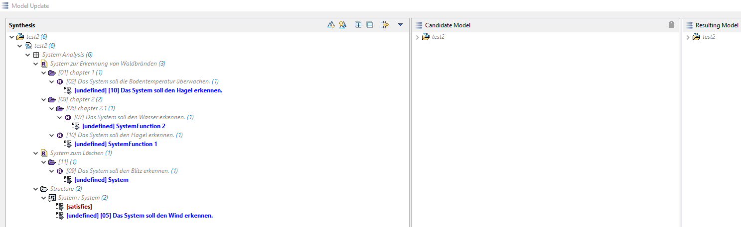

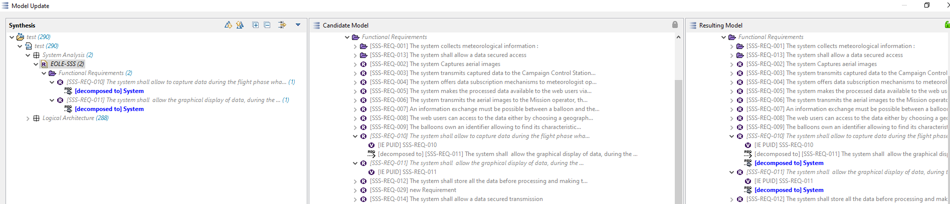

Second I started a reimport of the same reqif-file, see file: Capture2.PNG
The Diff-Merge-editor marked req-links between the requirements, which had been either source or target of the reqif-relation, and the system-components for removal.

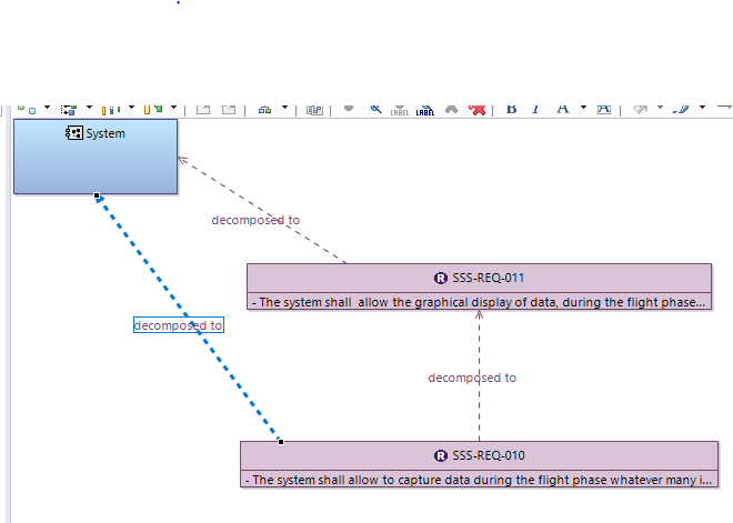

Completing the merge resulted in an updated SAB-diagram, see file: Capture4.PNG
index.php/fa/38613/0/
All links between requirements and architectural elements (components, functions) remained, ONLY when the requirement had NOT been referenced as source or target within a reqif-relation.
