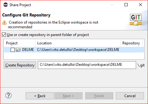

I have some doubts on a warning appearing.
I have ecplise opened on a workspace on C:\Users\Me\workspace.
I create a new project in C:\Users\Me\workspace\MyProject
I then want to put it into version control.
I do right click on "MyProject" -> Team -> Share project... -> choose git -> select "Use or create repository in parent folder of project" -> select MyProject from the list.
What is see is in the attached "share-project.png" image.
what I don't understand is what is the meaning of the warning, and why does it appear.
what I want to obtain is this "tree"
workspace
    MyProject1
        .git
        <stuff>
    MyProject2
        .git
        <stuff>
but I don't understand if there is a problem

The parent folder of the project would be "workspace". Having a git repo there is discouraged because it may include way more than you'd expect: also MyProject2 in your example, and even workspace-private data under workspace/.metadata.
I'd even say having git repositories physically anywhere under the Eclipse workspace directory is not the best setup. Personally I prefer to keep things completely separated: all my git repositories are under a "git" folder in my home directory, my Eclipse workspaces are elsewhere. Eclipse projects can be located physically outside the workspace directory. If you want that, the easy way to get that is to not use "Use or create repository in parent folder of project" but the "Create..." button.
sorry but I don't understand, the git repo is in the directory workspace\MyProject1, what informations are you talking about? surely not the workspace\.metadata directory, nor the workspace\MyProject2

Umm... I tried to follow your advice, but now I'm stuck with a different problem.
Maybe it's my eclipse setup (it's a very old version continually updated, so it may have accumulated some cruft), but if I do "team" -> "share project" -> "Git" and the click on the "Create..." button... nothing happens!
I will try later with a new ecplipse installation.
Could you be so kind to tell me what that button does?
Re: Creation of repositories in the Eclipse workspace is not recommended [message #1829371 is a reply to message #1829369] Thu, 02 July 2020 03:51 Go to previous message
The "Create..." button opens a dialog to create a new repository, by default suggesting a location under C:\Users\Me\git.
