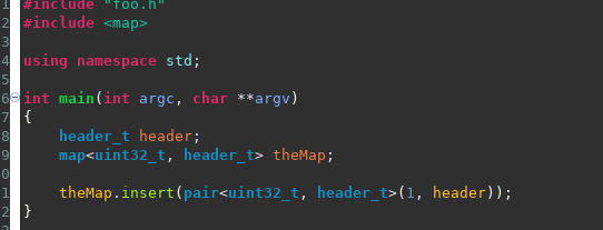

When I open foo.cpp in CDT editor, the editor displays a red line under
theMap.insert(pair<uint32_t, header_t>(1, header))
When I mouse over the line, the editor shows the error "Symbol 'pair' could not be resolved" and yet the file compiles fine.

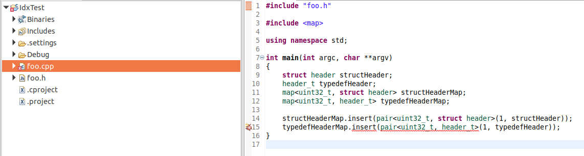

To illustrate my point, I created a new empty "C++ Managed Build" project and dropped foo.h and foo.cpp into the project directory. I then modified them as shown below. The files compile fine but Eclipse editor is still showing me the error, as shown in the attached screenshot.
#ifndef FOO_H_
#define FOO_H_
#include <stdint.h>
typedef struct
    uint8_t dataType;
    uint16_t offset;
    uint32_t ioId;
} header_t;
struct header {
    uint8_t dataType;
    uint16_t offset;
    uint32_t ioId;
#endif
#include "foo.h"
#include <map>
using namespace std;
int main(int argc, char **argv)
    struct header structHeader;
    header_t typedefHeader;
    map<uint32_t, struct header> structHeaderMap;
    map<uint32_t, header_t> typedefHeaderMap;
    structHeaderMap.insert(pair<uint32_t, struct header>(1, structHeader));
    typedefHeaderMap.insert(pair<uint32_t, header_t>(1, typedefHeader));
index.php/fa/38463/0/

Thanks again for your reply, however, I must respectfully disagree. The indexer is finding the include file as is apparent from my screen shot that shows no errors for the other declarations in that file. The indexer seems to be having problems with the typedef used with the STL map container or, more specifically, the "pair" template.
Another interesting twist to this is that I can make the error go away if I add a name into the typedef like this:
typedef struct _header_t
    uint8_t dataType;
    uint16_t offset;
    uint32_t ioId;
} header_t;
It is curious that you do not see the problem. Could you share your OS, Eclipse, and CDT versions? How can I generate a parse log?
