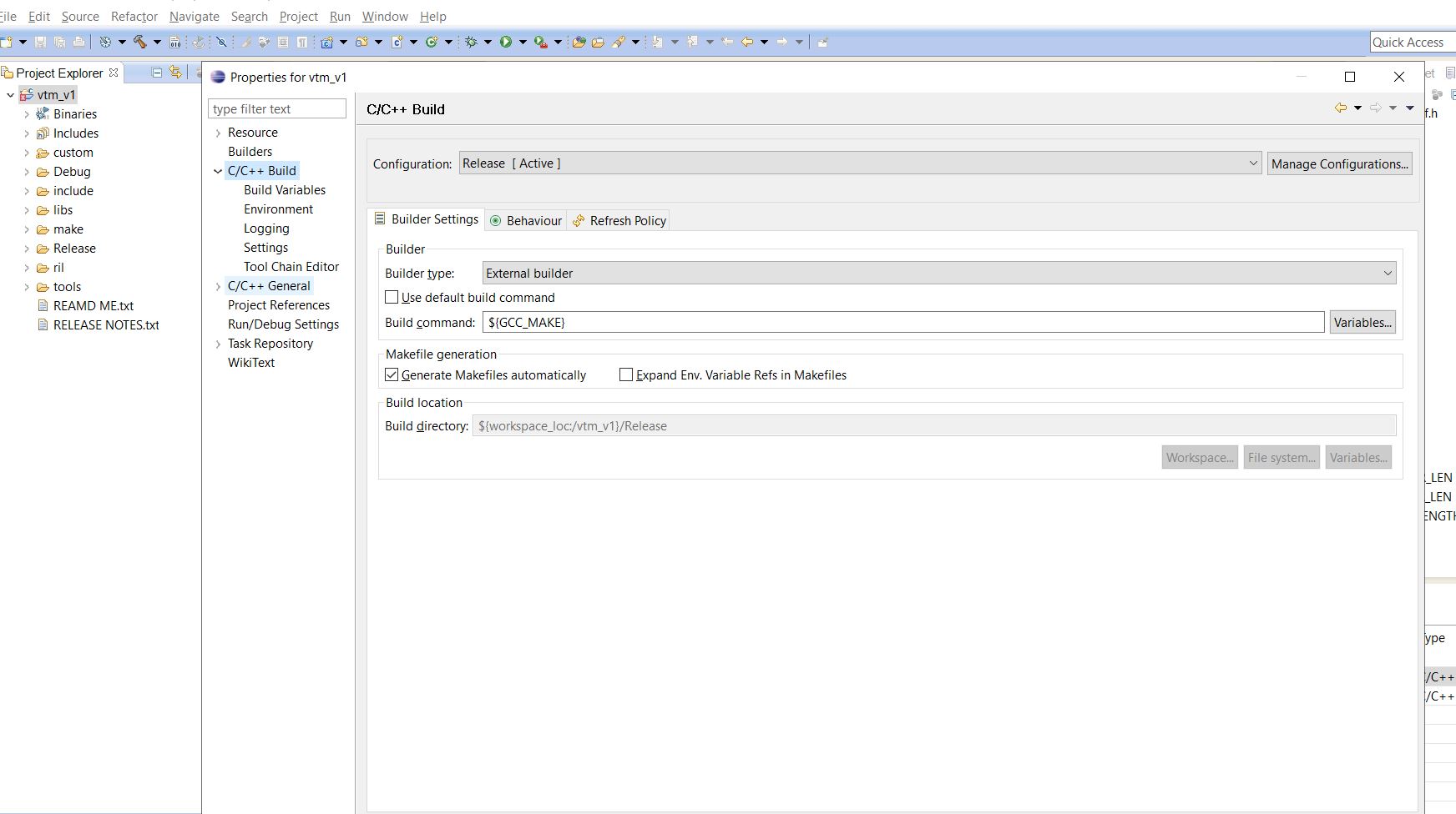

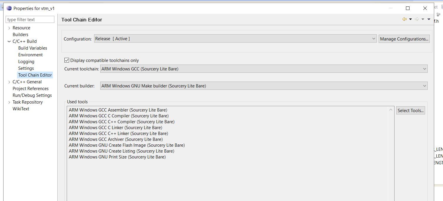

I am using eclipse IDE for program M66 gsm module. Before i used eclipse IDE in windwos 7. Currently i am using windows 10. I installed eclipse and tool chain arm-2012.09-63-arm-none-eabi.
But i am facing below mentioned problem.
1. Program "arm-none-eabi-gcc" not found in PATH
2. make: *** No rule to make target `APPGS3MDM32A01.elf', needed by `all'.

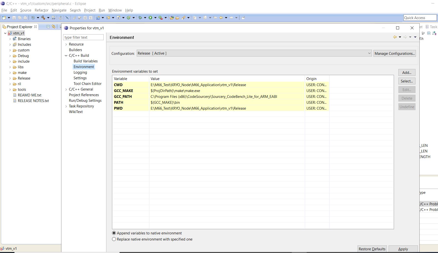

I set GCC path in c/c++ build/Environment. then also problem not resolved. Please help me to rectify this problem.
Please find the attached image for more details.

I doubt whether the path to gcc is correct. I find the following entries in "Environment" strange:
- GCC_MAKE: seems to point to a directory and an executable file within the Eclipse workspace, i.e. $(ProjDirPath)/make/make.exe. Is that really where the executable is?
- GCC-PATH: seems to point to the tool chain installation root directory. Is the gcc-executable really in that directory?
- PATH: if GCC_MAKE points to the make.exe, shouldn't PATH than not point to a directory where the real gcc executable (i.e. is arm-non-eabi-gcc.exe at $(ProjDirPath)/make/make.exe\bin ) is? And is it there?
