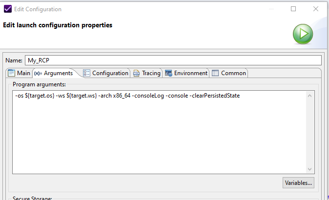

On IDE: Have you tried to add "-clearPersistedState" to program arguments of Application Configuration?
On Applications -> <your-_RCP> -> Configure... -> Advanced... -> Arguments -> Program Arguments
Afaik on rcptt runner "-clearPersistedState" must be added as "-autArgs", see http://rcptt.xored.com/arguments
