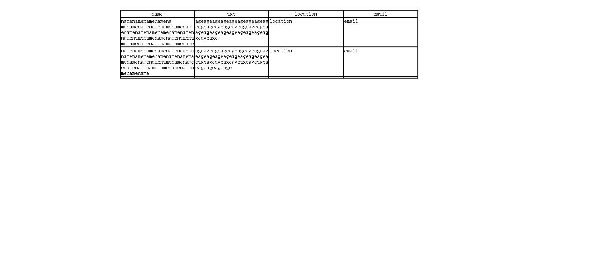

Hello everyone!
I need to center table in generated html and auto warp text in table cell.
Here is my rptdesign file:

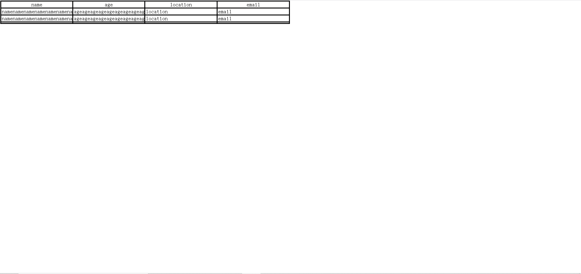

I am using birt 4.2.2 to generate html file:
        <dependency>
            <groupId>org.eclipse.birt.runtime</groupId>
            <artifactId>org.eclipse.birt.runtime</artifactId>
            <version>4.4.2</version>
        </dependency>
See got.png. It`s what I got.
See want.png. It`s what I want.
Please Help me, thanks!

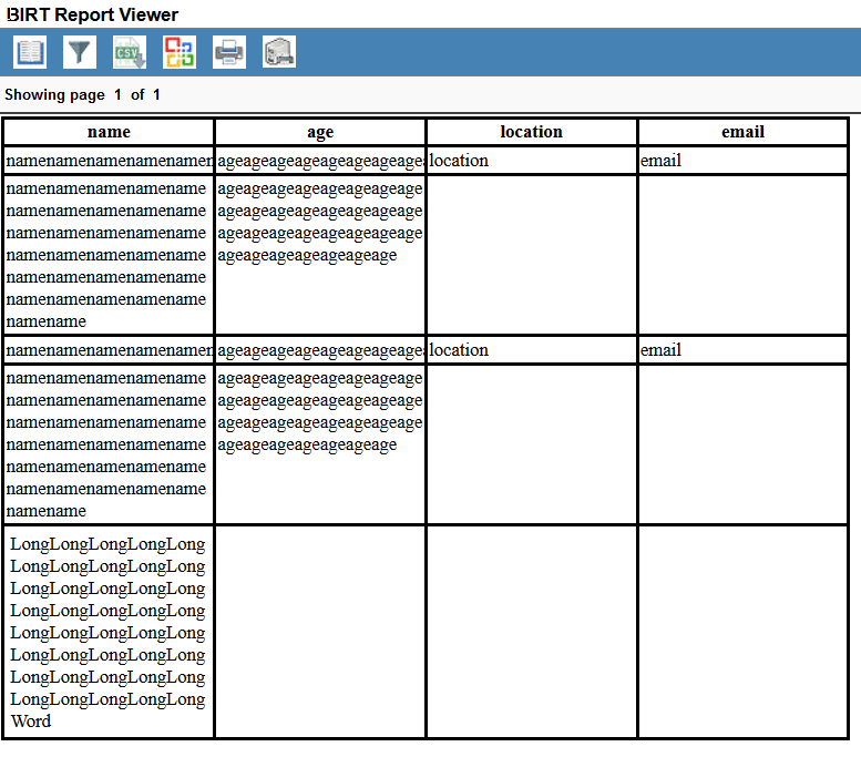

Hello There,
I have an solution for you.
The idea is to replace the default cell-data elemets with an text-element configured explicit like HTML.
And you can set in the HTML the correct wrapping.
The default wrapping doesn't work.
I have added for you the HTML preview and also a version of your report.
The HTML-text value is e.g.: <div style="word-wrap: break-word"><VALUE-OF>row["name"]</VALUE-OF></div>
Kind regards
Thomas
