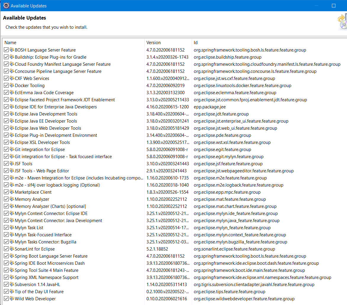

I moved back to Eclipse 2020-03, ran "Check for Updates" and installed whatever updates were available. When restarting Eclipse the same issue with "org.eclipse.core.internal.content.Activator.getFactory()Ljavax/xml/parsers/SAXParserFactory;" came back.
I installed a clean copy of Eclipse 2020-03, installed the plug-ins and imported my project. Everything ran fine. When I ran the "Check for Updates" again and restarted, again the error returned.
I can confidently state that the issue is neither with Eclipse 2020-03 or 2020-06. I grabbed a screenshot of the updates that were to be applied to Eclipse 2020-03 in the hopes are helping someone here figure out which plug-in or update is causing this issue. See attached pic.
