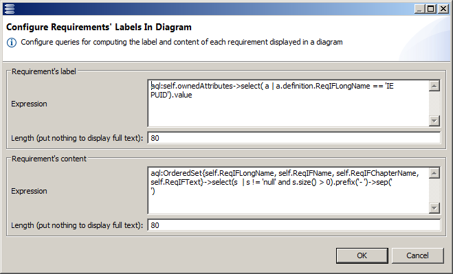

Re: Function automatic ID [message #1829544 is a reply to message #1829532] Mon, 06 July 2020 13:31 Go to previous messageGo to next message
The Requirements Add-On has a dialog that enables the customization of the labels that are shown on the diagram representations. You can use AQL expressions to customize it which is a very powerful feature.
If anyone would develop an extension to enable such feature for customizing functions, or other elements' labels it would be a good base to be copied... (if not already available somehow)
Re: Function automatic ID [message #1829547 is a reply to message #1829544] Mon, 06 July 2020 13:33 Go to previous messageGo to next message
Here is a screenshot of the dialog mentioned on the previous message:
index.php/fa/38506/0/
  • Attachment: Untitled.png
    (Size: 17.83KB, Downloaded 441 times)
Re: Function automatic ID [message #1829579 is a reply to message #1829547] Tue, 07 July 2020 04:37 Go to previous message
That is exactly what's needed I think. I wonder how to make the choice to enable such a thing only for specific elements...
