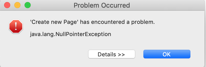

When Generating a new XXXTablePage, and we already have a XXXForm, a java.lang.NullPointerException exception is thrown and the method signature of getXXXTableData is not inserted in the existing services files.
The same exception occurs when generation XXXForm with an existing XXXTablePage, and the methods signature prepareCreate, create, store, load are not inserted in service files.
Environnment: MAC OS Mojave
JDK 1.8 (Also same exception with openjdk 1.8, 11 and 13).

Re: A Nullpointer exception in Eclipse Scout IDE 2010-Mars [message #1828670 is a reply to message #1828532] Tue, 16 June 2020 06:22 Go to previous messageGo to next message
Hi Seydou
Please open Help > About Eclipse SDK > Installation Details > Tab "Plugins" > Filter "scout".
What versions of the Scout SDK plugins are you using?
Also in Help > About Eclipse SDK: What is the exact Version and Build id of the IDE?
Thanks for the information
