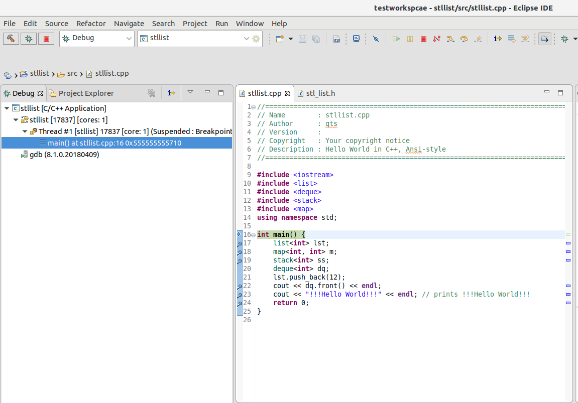

index.php/fa/38289/0/When I have a list class in my C + + function, When the push_ back function is used, G3 level debugging cannot be performed (it can be compiled and run, and G1 level debugging can be performed).
When I click F8 or next, the debug will not work normally, but will be stuck directly.
I suspect it's because of the list push_ back belongs to C + + 11,
I've tried push in other containers_ The back function, such as stack, is OK.
#include <iostream>
#include <list>
#include <deque>
#include <stack>
#include <map>
using namespace std;
int main() {
list<int> lst;
map<int, int> m;
stack<int> ss;
deque<int> dq;
lst.push_back(12);
cout << dq.front() << endl;
cout << "!!!Hello World!!!" << endl; // prints !!!Hello World!!!
return 0;
}index.php/fa/38289/0/index.php/fa/38290/0/

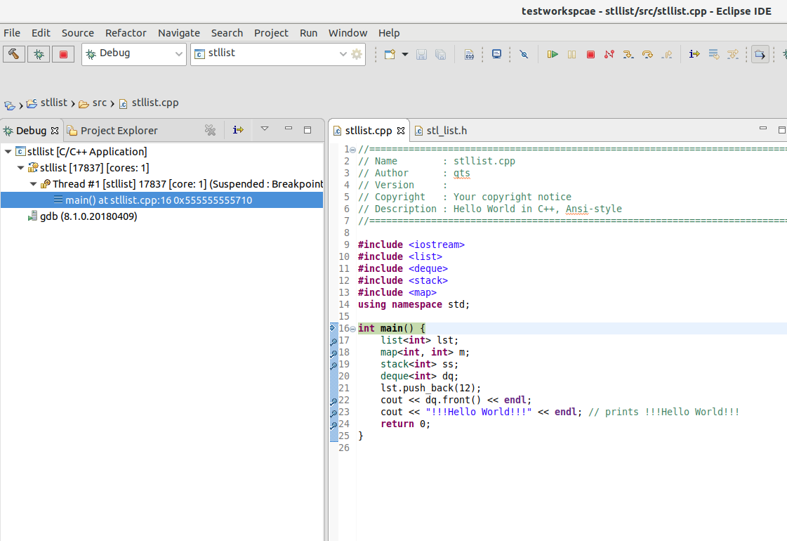

Re: -g3 debug not work,when list.push_back [message #1828441 is a reply to message #1828412] Tue, 09 June 2020 13:51 Go to previous message
Do you have optimization enabled?
If so, use -O0
UPDATE:
Using -g3 and trying to stop at main does indeed hang.
However, not stopping at main but on the lst.push_back() works as expected.
Also happens when using -g (equivalent to -g2)
This only seems to happen when the Variables view is being used.
If the Expressions view is selected instead, the debugger acts as expected.
It may be caused by the debugger trying to read the values of the variables before they have been initialized.
This can cause the debugger to appear to hang as it's caught in a never-ending search.
I've seen this behavior with uninitialized sets.
Moving the local variables to global may help and did so in this case.
But it may depend on the containers used.
I say "debugger" here and I mean Eclipse.
gdb won't try to list variables unless asked.
The only surefire way of avoiding this is to never stop the program
when there are uninitialized variables -- particularly if they are STL containers.
Note: the line of code cout << dq.front() << endl; is in error.
Using front() on an empty deque is attempting to fetch an undefined reference.
