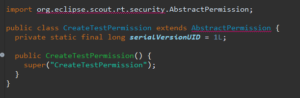

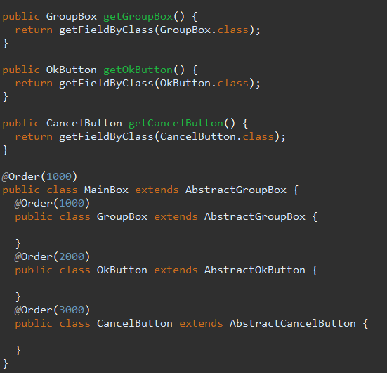

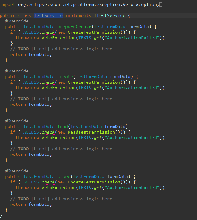

I´ve got a very weird problem. When I try to create a new Form through the scout wizard, it will be created but the code wont be coloured in a normal way. And the autocomplete feature wont work as well, it will give me results to autocomplete from but when I press enter nothing happens. In other forms/classes this still works. Also the services that are created with the form, are faulty as well. I´ll provide Screenshots of it. Does anyone know how to resolve this?

Ok so I just noticed that when I restart eclipse the form at least works properly now. But it is still weird.
Re: Scout Create Wizard not working properly [message #1828260 is a reply to message #1828245] Fri, 05 June 2020 03:24 Go to previous message
Hi Luis
I don't know what the problem was in your case, but here are some general tips:
  • Make sure that Project > Build automatically is checked.
  • Sometimes, running "Maven > Update project" on all projects can help (Alt-F5).
  • If it was caused by an error in a plugin, you might find some clues to the cause in the Eclipse error log (Window > Show view > Other... > Error Log).
