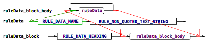

nb I also checked things an antlrworks (image attached)
Re: star files and Decision can match input such as [message #1828209 is a reply to message #1828187] Thu, 04 June 2020 02:11 Go to previous messageGo to next message
Data_block:
heading = DATA_HEADING (bodies+= Data_block_body)+
Data_block_body:
data+=(Data)+
if you have two data. will these become two Data_block_body or two (bodies+= Data_block_body)+

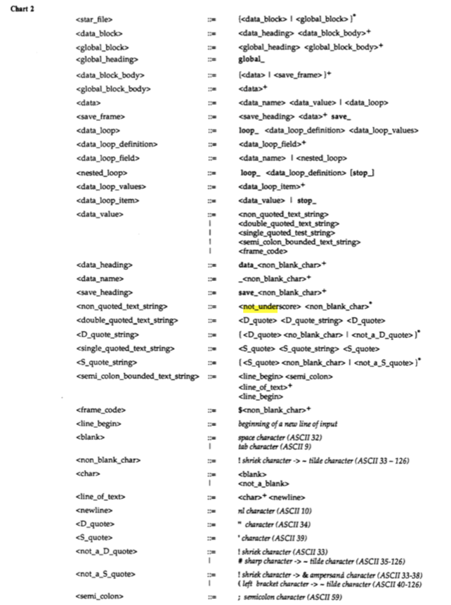

Thank you so much, I was barking up completely the wrong tree and this solves the problem. As you explained the original syntax from the original paper had a degenerate definition.
<data_block_body>              ::= (data | save_frame)+
<data>                         ::= data_name data_value | <data_loop>
<data_block>                   ::= <data_heading> <data_block_body>+
<data_name>                    ::= _<non_blank_char>+
<data_heading>                 ::= data_<non_blank_char>+
<save_frame>                   ::= <save_heading> <data>+
I now have
