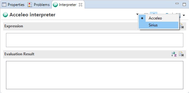

I've created a new Ecore Modeling Project and opened the Interpreter view (make sure the Sirius interpreter is selected, and not the Acceleo one).
The auto-completion seems to work properly after aql: in my environment
Cuuld you try with a simple Ecore Modeling Project to make sure it is not linked with your modeler?
Re: Auto completion in Sirius interpreter does not work [message #1828262 is a reply to message #1828258] Fri, 05 June 2020 03:40 Go to previous messageGo to next message
I've attached a screenshot displaying the menu to change the interpreter.

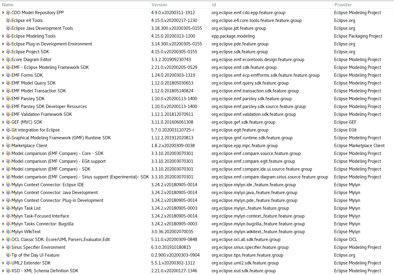

Here my installation details:
index.php/fa/38281/0/
In addition of the 2020-03 Modeling package, I installed the Sirius Specifier feature. That could be an explanation.
Re: Auto completion in Sirius interpreter does not work [message #1828352 is a reply to message #1828348] Mon, 08 June 2020 06:03 Go to previous message
Florian, you were right! I installed the Sirius Specifier feature and I can confirm it indeed solved the problem. Can I suggest that it should be integrated into the next distribution of the Modeling tools IDE?
