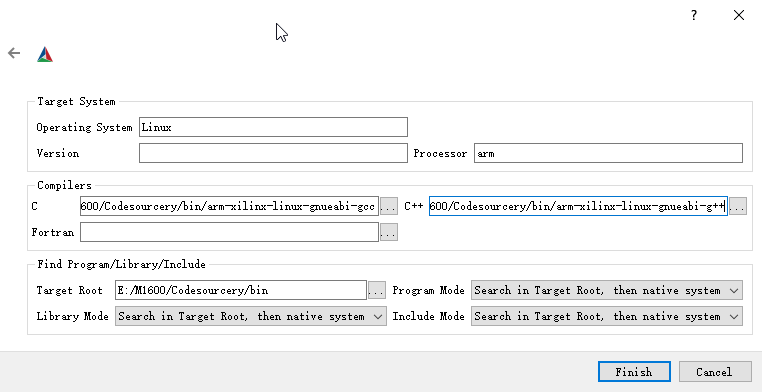

when i choose the arm-xilinx-linux-gnueabi-gcc,arm-xilinx-linux-gnueabi-g++
under toolchain in cmake, the errors occur

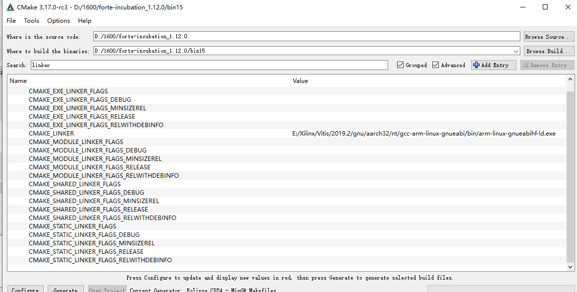

I installed vivado 2019.2 then i use the gnu under E:\Xilinx\Vitis\2019.2\gnu\aarch32\nt\gcc-arm-linux-gnueabi\bin
the the cmake-gui can configure it, but i don't know how to link a library(.a) with forte, in cmake-gui or develepment tool

  • Attachment: snap1.png

Re: Compiling forte with xilinx toolchain failed [message #1828126 is a reply to message #1828124] Tue, 02 June 2020 03:49 Go to previous messageGo to next message
the interesting information would be in:
See also "D:/1600/forte-incubation_1.12.0/bin12/CMakeFiles/CMakeOutput.log".
See also "D:/1600/forte-incubation_1.12.0/bin12/CMakeFiles/CMakeError.log".
but i also see a few things that you could consider:
1. I don't think that E:\M1600\Codesourcery\bin is the right directory as target root. In my setups the bin was never the correct one
2. if it is a very special platform you may need a target configuration cmake file with additional compiler and linker flags
3. since quite some time we recommend that the build directory should not be within the forte code that you downloaded. This makes it easier for you to seperate your developments from the offical forte code.
Re: Compiling forte with xilinx toolchain failed [message #1828129 is a reply to message #1828126] Tue, 02 June 2020 04:18 Go to previous messageGo to next message
both
E:\M1600\Codesourcery\bin and E:/M1600/Codesourcery/arm-xilinx-linux-gnueabi/bin
didn't work, they had the same error in CMakeError.log

Re: Compiling forte with xilinx toolchain failed [message #1828135 is a reply to message #1828129] Tue, 02 June 2020 05:15 Go to previous messageGo to next message
joy woo wrote on Tue, 02 June 2020 08:18
both
for me it is never a bin directory. for any linaro toolchain always the toolchain root file seems to work best.
Compiler: E:/M1600/Codesourcery/arm-xilinx-linux-gnueabi/bin/gcc
Build flags:
Id flags:
The output was:
%1 is not a valid Win32 application
i downloaded two different versions of xilinx toolchian, but none of them worked.
I think there are some cross compilation settings missing. Cmake is trying to check if the application generated works for your host OS. There are some options that can tweak that. Please search for cross compilation and CMake to check for them.

how to add libary .a into forte in cmake-gui ?
Re: Compiling forte with xilinx toolchain failed [message #1828142 is a reply to message #1828141] Tue, 02 June 2020 10:20 Go to previous messageGo to next message
linker options?
Re: Compiling forte with xilinx toolchain failed [message #1828143 is a reply to message #1828142] Tue, 02 June 2020 10:23 Go to previous messageGo to next message
I didn't find it
  • Attachment: s2.png
    (Size: 46.00KB, Downloaded 95 times)
Re: Compiling forte with xilinx toolchain failed [message #1828416 is a reply to message #1828143] Tue, 09 June 2020 08:42 Go to previous message
