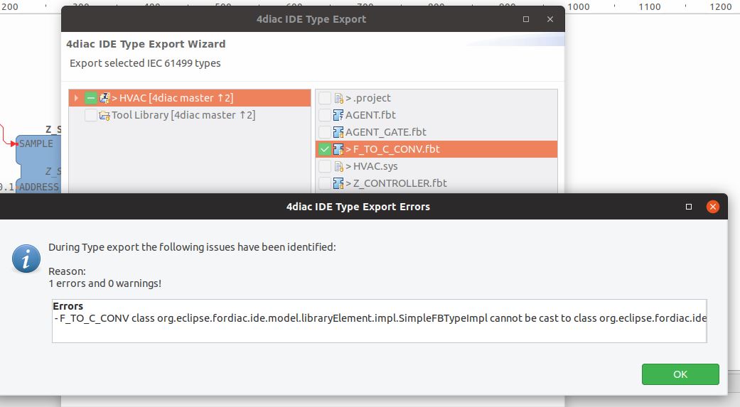

I just updated to 4diac 1.12.2 but was unable to open any of my previous applications. While they were opening, Eclipse told me that the workspace was incompatible.
Since the application was easy to re-create I did so and brought in copies of my SIFB's into the new application. They all re-exported fine but one based on a simple Basic Function Block would not export (image is attached separately)
Did I do something wrong during the upgrade? I'll try to re-create this BFB from scratch and see if it exports this time.

This is the full text of the error message:
Errors
- F_TO_C_CONV class org.eclipse.fordiac.ide.model.libraryElement.impl.SimpleFBTypeImpl cannot be cast to class org.eclipse.fordiac.ide.model.libraryElement.BasicFBType (org.eclipse.fordiac.ide.model.libraryElement.impl.SimpleFBTypeImpl and org.eclipse.fordiac.ide.model.libraryElement.BasicFBType are in unnamed module of loader org.eclipse.osgi.internal.loader.EquinoxClassLoader @7e28f150) (F_TO_C_CONV.fbt)

Regarding your export problem. could you be so kind and write a bug report on it. May I have your FB for testing?
