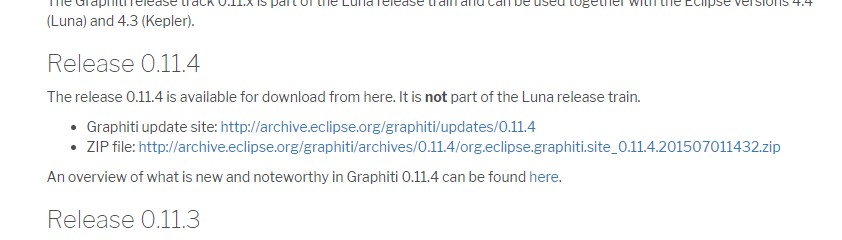

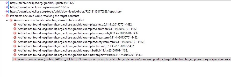

Greetings graphiti community,
I take part in the development of a project which requires graphiti 0.11.4. Until recently I grabbed graphiti from the software site at the graphiti archive, but now I am getting an error message at the target definition telling that the artifacts cannot be found.
I tried with the zip file listed next to the software site URL at the graphiti download page, but I get the same result.

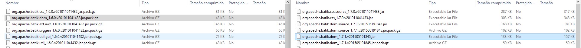

Looking to the zip contents and comparing to more recent versions (from version 0.14.0), I observed that version 0.11.4 misses a .jar file for every artifact. ¿Maybe the upload site is broken?
I have attached some captures of what I have described to this post.
Sorry if this is not the appropriate place to discuss this issue, but I hope you can help me to solve it.

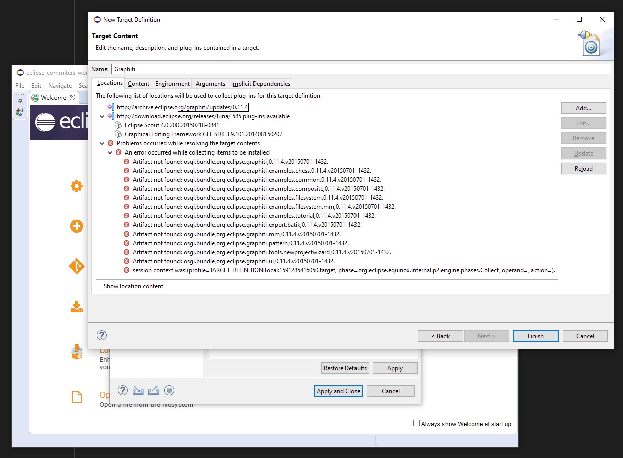

Thank you for your fast response and sorry for the delay. I have tried again a minute ago. This is what I have done:
1. download a fresh copy of Eclipse for Eclipse commiters
2. start Eclipse, pick a non existing directory as workspace
3. add a new Target Platform with nothing
4. add Luna software site (http://download.eclipse.org/releases/luna/) and Eclipse Scout and GEF SDK
5. add Graphiti 0.11.4 update site (http://archive.eclipse.org/graphiti/updates/0.11.4) and Graphiti

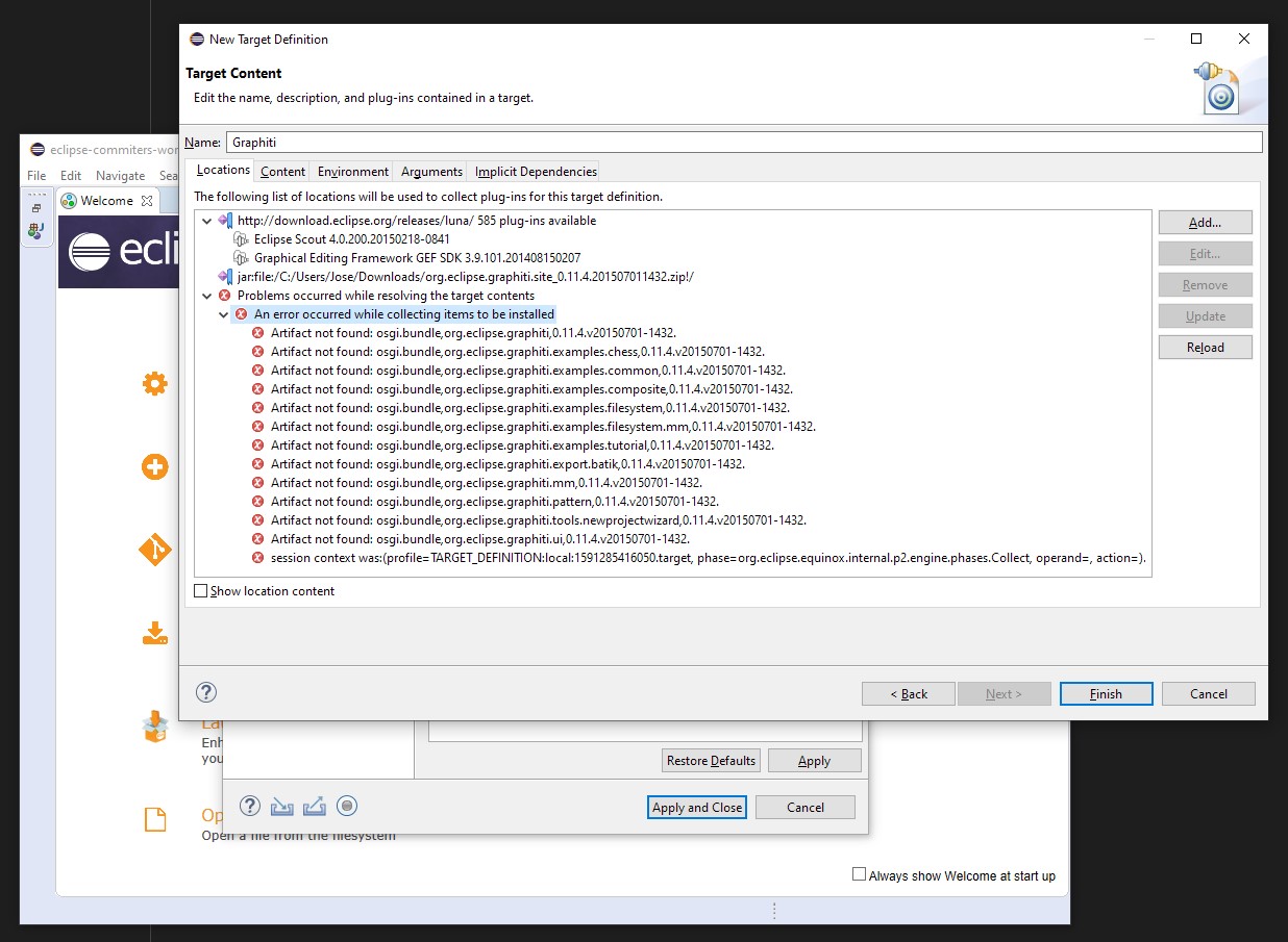

I get the same "Artifact not found" error message. If I replace Graphiti update site with the downloadable zip, the results are the same.
That version of Graphiti is a dependency for a third party plug-in that we use at our project and that is not longer actively mantained. We prefer not to modify the third party plug-in, though. So, that's the reason why we need Graphiti 0.11.4.
I realised that I cannot get Graphiti artifacts from the archive update site because I lost my workspace not long ago and I had to configure the project development environment again.
Thank you once more.
