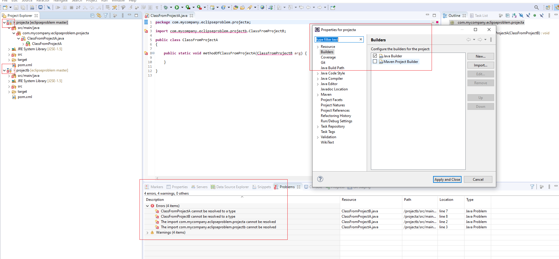

Re: Eclipse m2e plugin issue for cyclic dependent projects [message #1827789 is a reply to message #1827774] Sat, 23 May 2020 18:13 Go to previous messageGo to next message
Hi Stephan,
Many thanks for the response.
I tried disabling maven builder, but it did not help...
https://github.com/simpleusr/eclipseproblem/blob/master/attachments/removemavenbuildererror.png
