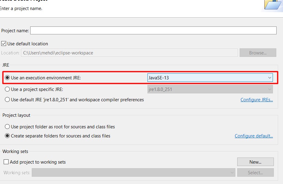

I have downloaded the latest version of JAVA SE 14, I have updated the path of the variable. This happens when I try to create new project
Eclipse V: 2020-03 (4.15.0)
JAVA SE 14.0.1

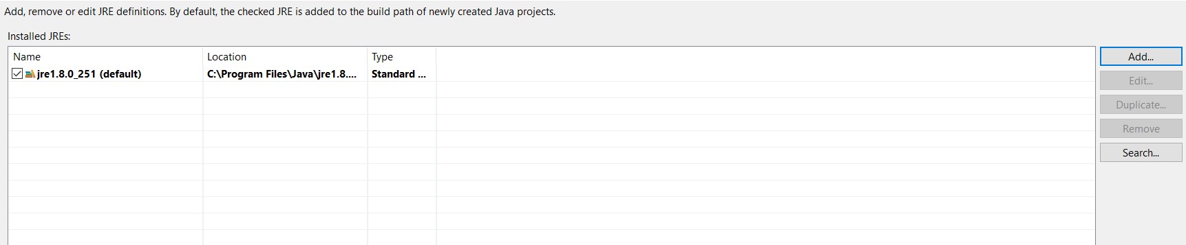

Add its location to the Installed JREs preference page and check its box so that it is the default. Note that Java 14 technically does provide a JavaSE-13 execution environment, it just happens to provide more as well.

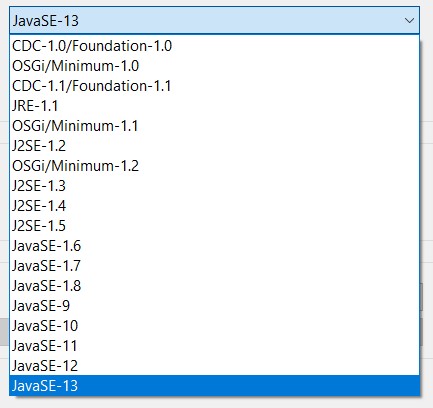

Nitin Dahyabhai wrote on Thu, 21 May 2020 15:48
Note that Java 13 technically does provide a JavaSE-13 execution environment, it just happens to provide more as well.
I tried to pick from the drop down, it shows Java 13 as the latest
index.php/fa/38165/0/

When you say, Add its location to the Installed JREs preference page, do you mean here
index.php/fa/38167/0/

Re: JRE using JavaSE-13, how to overwrite it to SE 14 [message #1827784 is a reply to message #1827756] Sat, 23 May 2020 13:39 Go to previous messageGo to next message
Oh, I see. The problem is that 14 isn't selectable? For 2020-03 you'll need to install https://marketplace.eclipse.org/content/java-14-support-eclipse-2020-03-415 to have Java 14 support--Java 14 was only released the day before 2020-03 shipped. I expect it'll be included in 2020-06.
