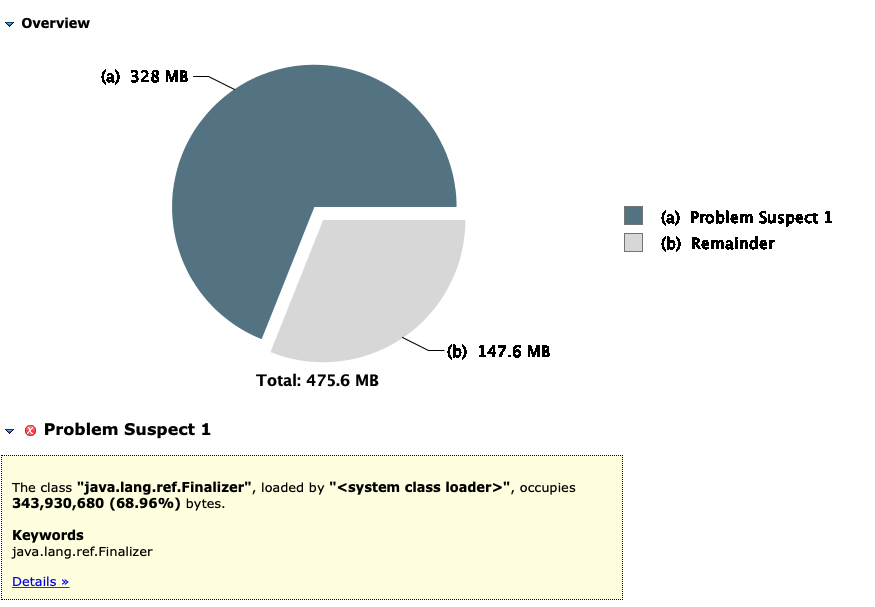

MAT says
The class "java.lang.ref.Finalizer", loaded by "<system class loader>", occupies 343,930,680 (68.96%) bytes.

How I can through this information find the place in code which I can fix. I found through
SELECT OBJECTS referent FROM INSTANCEOF java.lang.ref.Finalizer all objects that Finalizer wants to finalize().
Pressing show as histagram I grouped these all.
But how I can find which of this objects stucks through finalize process? And in which place in my code?
Thank you very much.

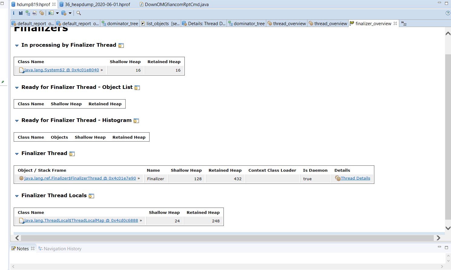

Have you tried running the 'Finalizer Overview' query?
Query Browser > Java Basics > Finalizer Overview

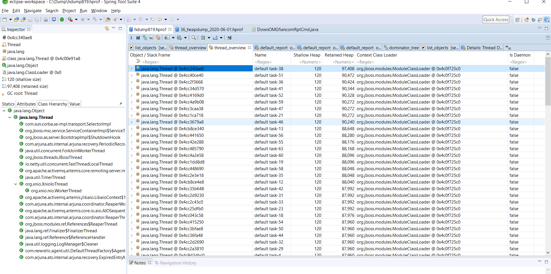

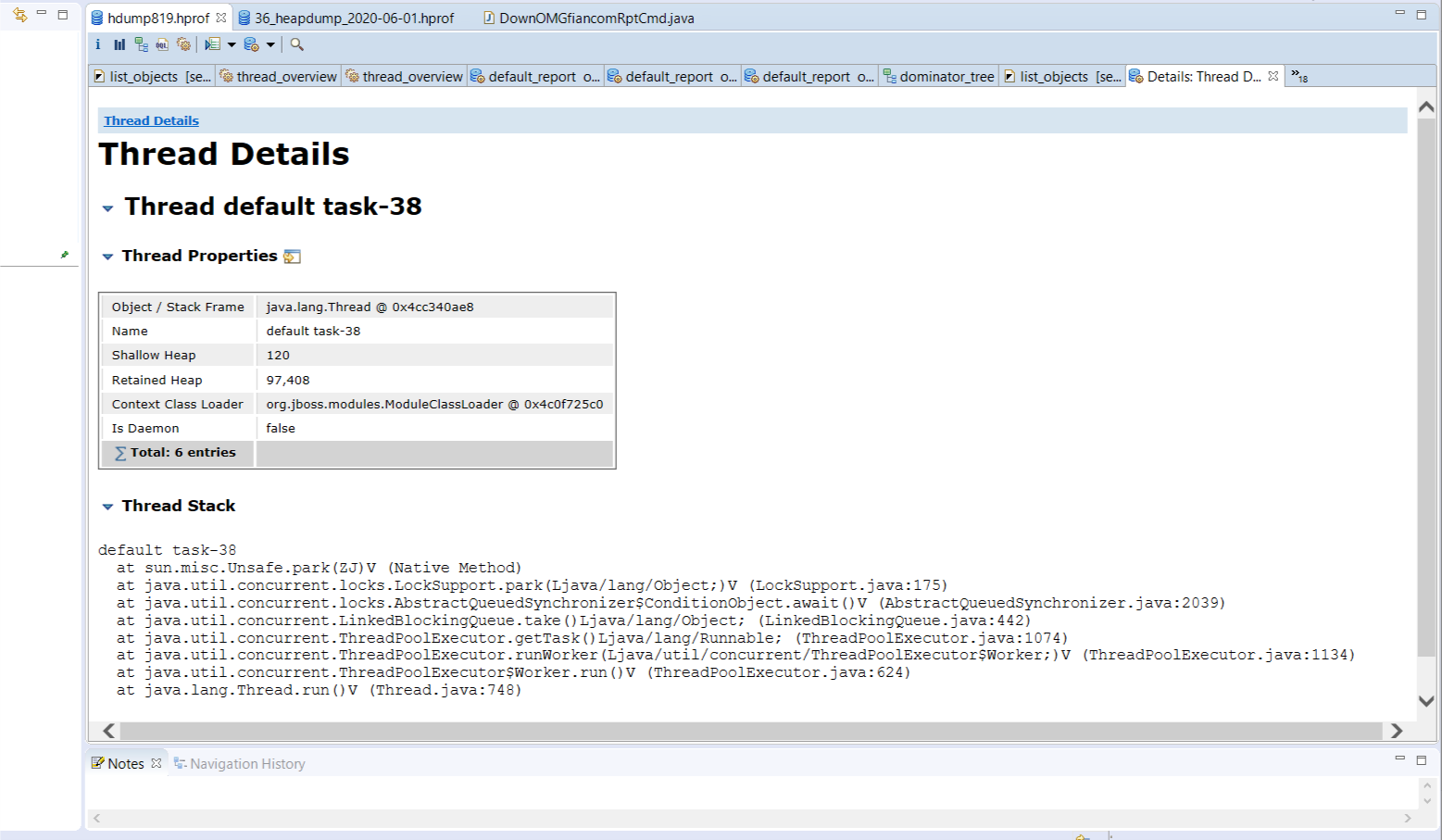

I am facing a similar kind of issue, where the Finalizer() thread is stuck. I think it is due to thread blocking. But dont know what is causing the issue. any help ?

I don't think the finalizer thread is stuck.
There is nothing on the finalizer queue.
The 'In processing' java.lang.System$2 object is just a local variable in the initial stack frame java.lang.ref.Finalizer$FinalizerThread.run()V

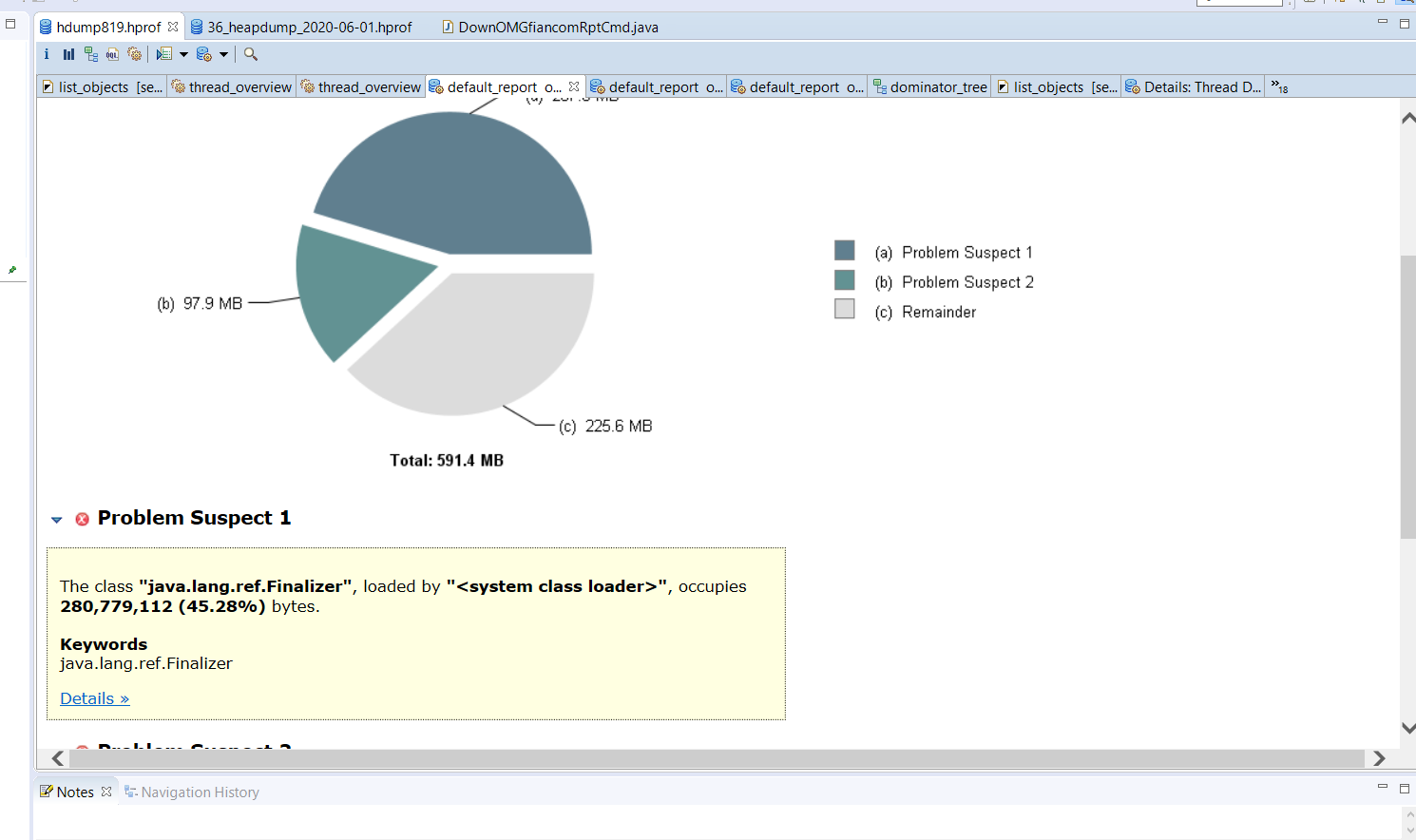

Try examining more carefully the details of problem suspect 1.
Try using the latest version of MAT - 1.10 or perhaps a snapshot version.
