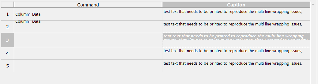

I'm a newbie in eclipse Nattable technology. I have started learning and using it for the past 1 week. I'm using a GridLayer which has the datalayer, row, column and corner Layer. I just have 2 columns in the Grid and Sometimes one of the column's data exceeds the Column Width. In that case, I tried to wrap the text using the painter AutomaticRowHeightTextPainter. Unfortunately, It was still displaying in single line. Hence, I consulted the Nattable example AutomaticRowHeightExample and it seems to work fine if there is only the data layer.
When I try to port the same solution to the Grid Layer, it does not work as I expected. When I debugged, in (AutomaticRowHeightTextPainter) TextPainter.paintCell API, the lines are being correctly split into 3 lines. But, when the file Grid is rendered, The Row has been resized to accommodate 3 lines, but, only one line is visible and somehow, when I click on that cell, it seems that the 2nd and 3rd line are hiding under the first line in the cell. (How do I know, there are some broken characters visible from the 2 line).
Strangely, I started seeing blank links for the first column data too.
Please, let me know What I'm doing wrong or a place to start debug and find it out the real problem.
I always return "Column1 Data" for first column Column and "test text that needs to be printed to reproduce the multi line wrapping issues, that I'm yet to solve in the GridLayer, that I started to use today morning :)" for the second column.

The issue you are facing is that the AutomaticRowHeightTextPainter is calculating the row height per cell. You have configured it for both columns, so one column will tell it to increase, the other says to decrease. So actually the rendering and state changing of row heights is not in sync at some time. If only the second column is the one that could have multiple lines, then you should only configure the second column with the AutomaticRowHeightTextPainter, not the whole table.

As you have mentioned that the AutomaticRowHeightTextPainter was being applied to both the Column, is the real problem. Now, I have updated the code to invoke the Painter from my second column, which is the column, which might have data line, which needs to be wrapped into multiple lines.
Thank you for your reply and Have a good day :)
In case, anybody wondering how the issue is fixed
1. Set a ColumnOverrideLabelAccumulator to the DataLayer.
2. Added label for each column index to the accumulator.
3. Updated the configuration to return the AutomaticRowHeightTextPainter for the second column.
