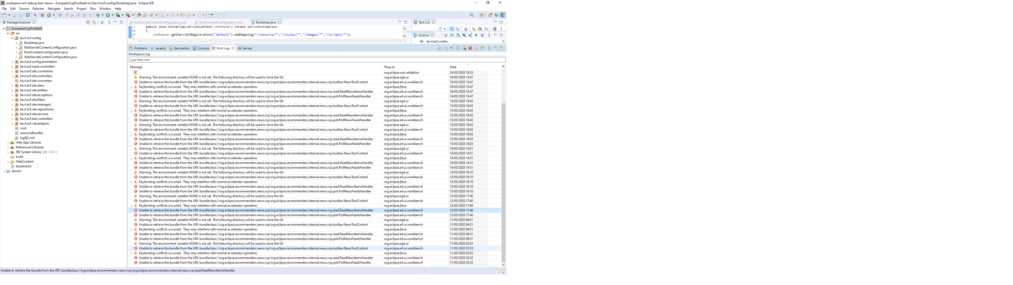

I made a conversion from Eclipse Oxygen to Jee-2020-03 and from Java 8 to Java 14.
I repaired some errors of this conversion and some deprecated methods, classes or interfaces.
I don't know what to do ...
