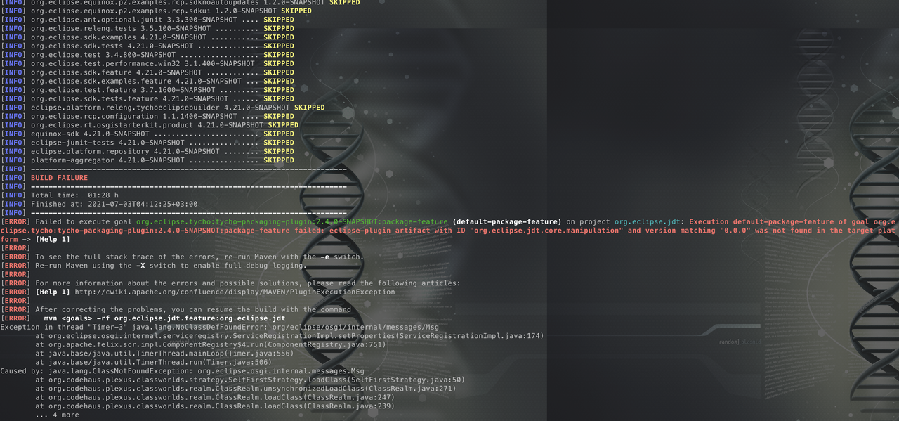

Re: The Future - ARM CPU's [message #1842608 is a reply to message #1830637] Fri, 25 June 2021 09:32 Go to previous messageGo to next message
I was trying to compile Eclipse from source on Raspberry Pi, and to do that I've started with compiling SWT - since Eclipse needs SWT to run (and this is the sole platform dependent component as far as I understand)
And guess what - you need Eclipse to compile SWT! Chicken and egg. Insane!
Does anyone know how to compile SWT from command line, or whether it's even remotely possible?
Any help is appreciated.

Re: The Future - ARM CPU's [message #1842628 is a reply to message #1842620] Fri, 25 June 2021 13:26 Go to previous messageGo to next message
Sorry, I was reading the JAR instructions, indeed the native build refers to using Eclipse.
However, you should be able to trigger the local build using maven. I don't have instructions for you. But the exact same question is asked in the mailing list. So you might not like that in communication, you will find (parts of) your answer there. Moreover, hardly any of the Platform developers monitor the forum so you will not get much of an answer here.
A better overview of the mailing list thread: https://www.eclipse.org/lists/platform-dev/threads.html#03037
Some inspiration can be found here too, but don't use the chromium parts: https://github.com/eclipse/eclipse.platform.swt/blob/master/bundles/org.eclipse.swt.browser.chromium/README.md

Stuck with this issue now:
https://i.postimg.cc/28tK5sbX/Screenshot-2021-07-03-at-04-16-03.png
Re: The Future - ARM CPU's [message #1842887 is a reply to message #1842877] Mon, 05 July 2021 04:08 Go to previous messageGo to next message
Looks like creating of the org.eclipse.jdt feature is failing, probably due to an earlier error while building the org.eclipse.jdt.core.manipulation plugin. Check the full log for errors and warnings to see where the problem occurs.
Re: The Future - ARM CPU's [message #1846939 is a reply to message #1842887] Sat, 09 October 2021 10:13 Go to previous message
