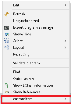

I have created a context menu item for diagram. It is coming at down/end of the context menu. Is there any way to place the created item at top/as first item?

Re: How to place context menu item at top [message #1827229 is a reply to message #1827222] Mon, 11 May 2020 03:21 Go to previous message
I think that this documentation will help you : https://www.eclipse.org/sirius/doc/specifier/diagrams/Diagrams.html#group
To answer quickly, it is not possible to add the action to a specific location but at least in a specific group, as said in the documentation "Currently, it is not possible to add a group after or before a specific existing group. It is added at the end of the menu having the corresponding id.".
