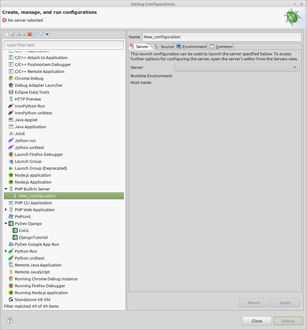

I notice (through diligent poking around and no luck at all searching on-line) that on the Run menu, Debug Configurations opens the Create, manage and run configurations window, on which is an entry PHP Built-in Server. Right click that and New Configuration and there's one listed called New_configuration.
Getting warm we think, so click New_configuration, and on the right is a panel four tabs, Server, Source, Environment and Common. Screenshot attached.
There is a conspicuous drop down beside the label Server: on the Server tab which is displayed by default. It is blank, and disabled. Great. Looks totally unconfigurable. But hey, we have a Built-in server called New_configuration now, so close, check the setting stuck, and try Debugging again.
Same deal. Opens an internal browser and displays only "Could not connect: Connection refused".
Shrug. Great stuff. Easy no? Find no clues on-line only stuff that says it should work. Like this lovely tutorial:

  1. I have no idea what's up with Eclipses PHP Build-in Server? Where is that? How does that even try to work?

Re: How to Debug with Eclipse and PDT, specifically how to use the Built-in Server [message #1827187 is a reply to message #1827178] Sat, 09 May 2020 16:41 Go to previous messageGo to next message
Default PHP Server != Built-in PHP Server.
Built-in php server support was donated by community, but currently is extremely buggy and require some love. In current state it use some kind of deploy and on each run/refresh during internal copy. So due this is not widely promoted. Anyway, It can be configured via Servers tab. If is not available use Window -> Show View -> Other.
"Default PHP Server" (and other registered in Settings -> PHP -> Servers) is generally used for patch mapping. Mostly for remote debugging. We had discussion in past to clean this up, but we need volunteer ;) Maybe after migration to GitHub we will find someone.

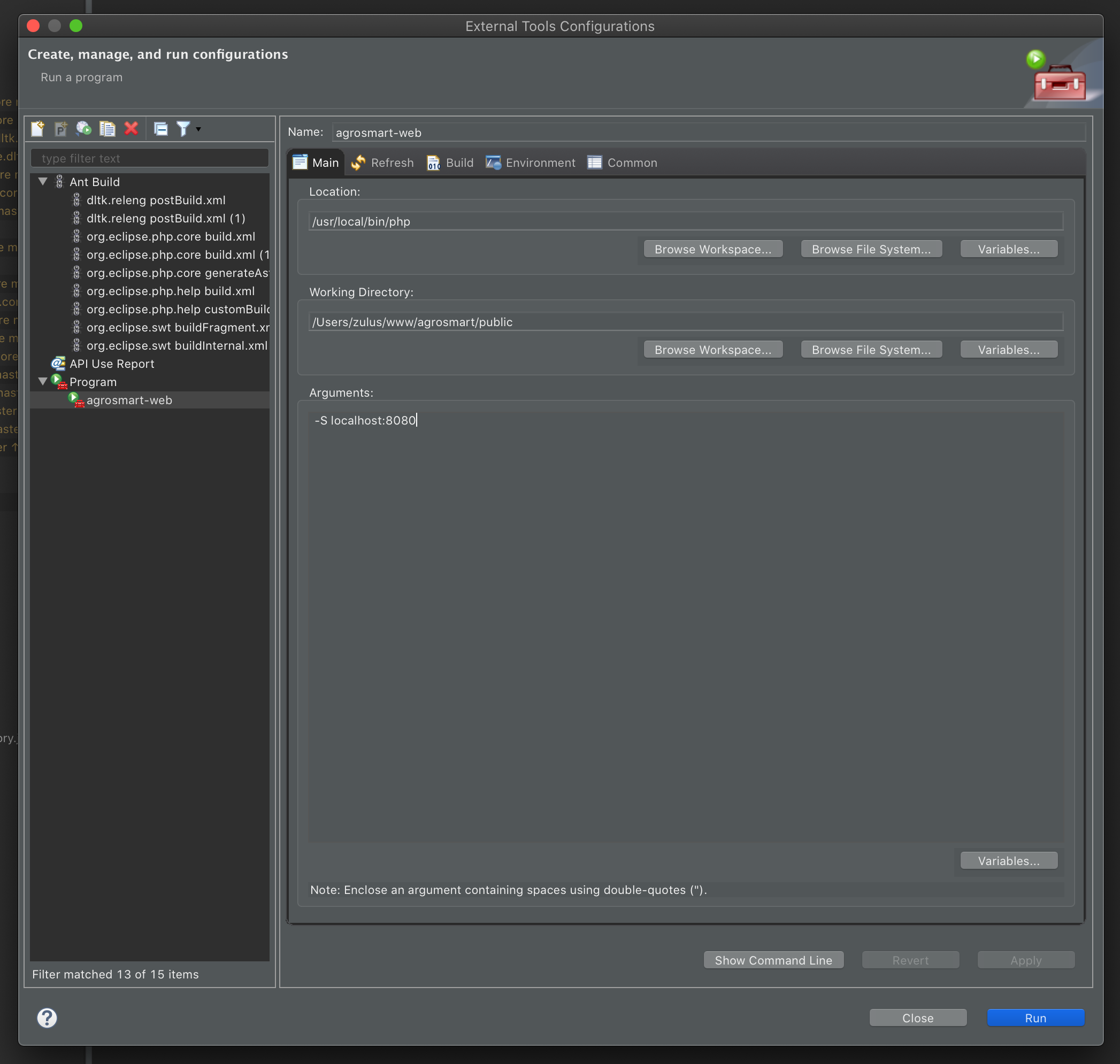

Setup built-in server:
1. Go to external tools configuration
2. Select program
3. Add new (icon on top left)
4. Setup location, for example: /usr/local/bin/php74
5. Setup working directory, for example: /Users/username/www/my_proect
6. Add arguments, for example -S localhost:8080
7. On common tab make sure "Allocate console" is checked (this is default)
You can also pin this config to external button. No play and go to localhost:8080. Output will be inside allocated console. Program will stop if you close eclipse.

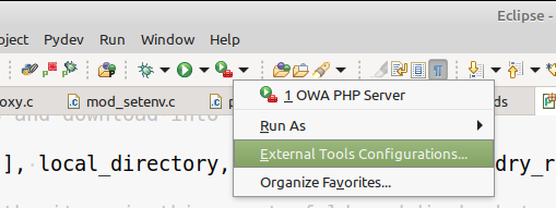

Thanks enormously David. Paying keen attention and eager. But do note that I cannot see the External Tools configuration. All I see is this:
https://www.eclipse.org/forums/index.php?t=getfile&id=38076&
Am I looking in the right place? Is something broken?
Re: How to Debug with Eclipse and PDT, specifically how to use the Built-in Server [message #1827200 is a reply to message #1827199] Sun, 10 May 2020 08:21 Go to previous messageGo to next message
If you use Eclipse for PHP package you should see "external tools" button right after "profiling, on toolbar: debug, run, profile, external tools.
See also: https://help.eclipse.org/2020-03/index.jsp?topic=%2Forg.eclipse.platform.doc.user%2Ftasks%2Ftasks-exttools-running.htm
We definitely have to improve/introduce "out of box" experience. Another task on my enormous TODO ;)
Re: How to Debug with Eclipse and PDT, specifically how to use the Built-in Server [message #1827201 is a reply to message #1827200] Sun, 10 May 2020 08:24 Go to previous messageGo to next message
Example configuration screen
Re: How to Debug with Eclipse and PDT, specifically how to use the Built-in Server [message #1827202 is a reply to message #1827201] Sun, 10 May 2020 08:37 Go to previous messageGo to next message
Thanks, External Tools rocks, added it now. Indeed, I am taking notes for a quick start guide ;-).

I am happy of course to run the "php -S" server, though if I can configure it to start this server automatically what a nice slick boon. So I looked for External Tools as suggested by find only the attached. Namely a dialog that offers no configuration at all alas. What am I missing there?

Guess it depends on what version of Eclipse. But I have the latest and I see it on my toolbar as per attached image. I admit it's not easy to find, and I wish it were clearer, but hey, there it is.
