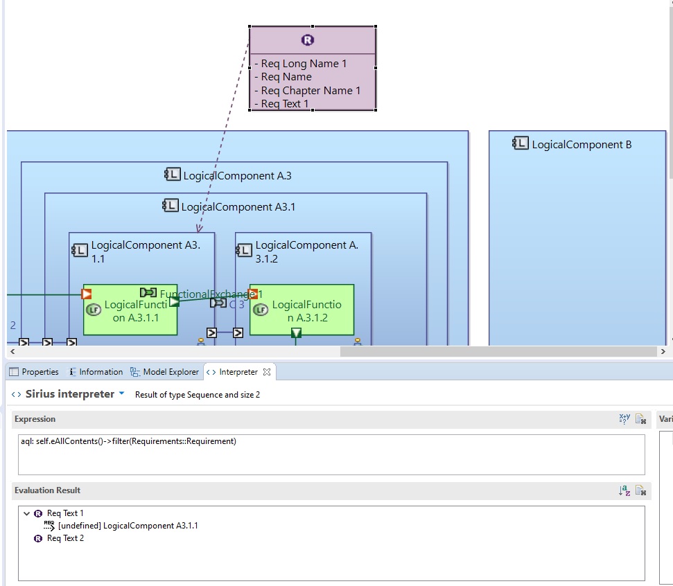

However, I recently worked on M2Doc templates with requirements. I managed to get them by using the following query : self.eAllContents()->filter(Requirements::Requirement)
So for instance you can get the requirement names by typing: self.eAllContents()->filter(Requirements::Requirement).ReqIFName
Other solutions may exist but this worked great for my case.

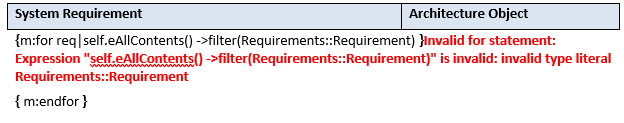

Hello, thanks for fast reply, but for me it doesn´t work, beside the sirius interpreter works fine, in the template it doesn't.
Invalid for statement: Expression "self.eAllContents() ->filter(Requirements::Requirement)" is invalid: invalid type literal requirements::Requirement
May be It is a problem in the nsURI (expert) Settings?
I am using Capella 1.4.1, Requirement VP and M2Doc 3.1

Re: how to edit "Requirements Viewpoint" requirements with M2DOC [message #1833505 is a reply to message #1833482] Thu, 15 October 2020 04:47 Go to previous messageGo to next message
Ok, I had problems in the 'Sirius Session' because of used 'space' in the .ard name..... There should be an advise not to use blank/space in the project naming!
After hours of renaming and 'reapair'/refresh it is working now.....
