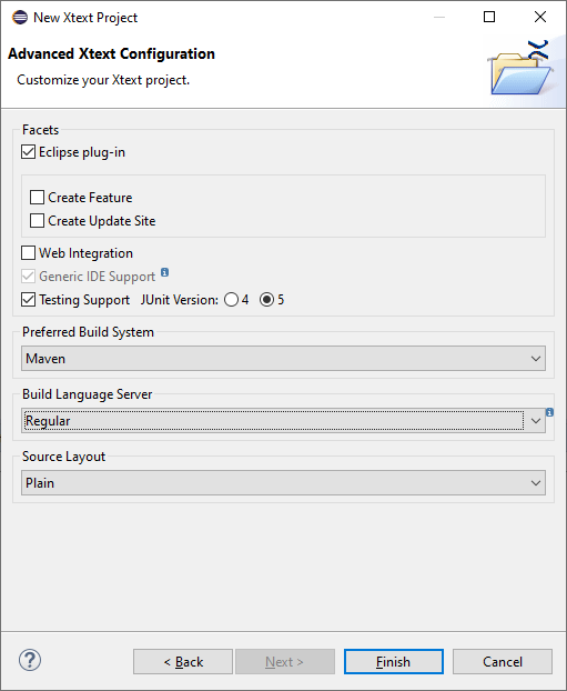

Thanks for all your support, after a few hours of strugle I managed to make it work. Here are the steps i followed for some future reference:
as christian has anticipated I didn't have any CI or complex maven setup I cared about
- create an xtext project with the same name and workspace as the old one (there will be some copy and paste and this will make it easier)
- select "eclipse plugin option" if you need it
- select Gradle as build system
- select normal as "language server"
- select "web" if needed and click finish
