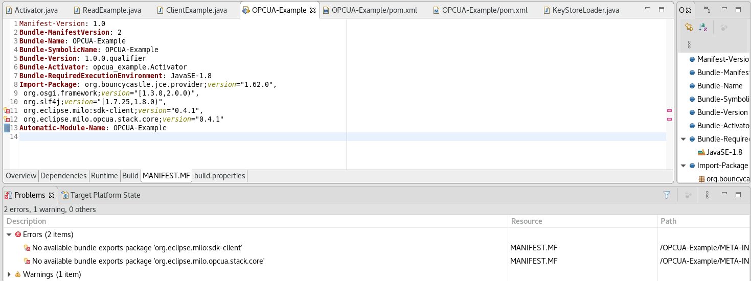

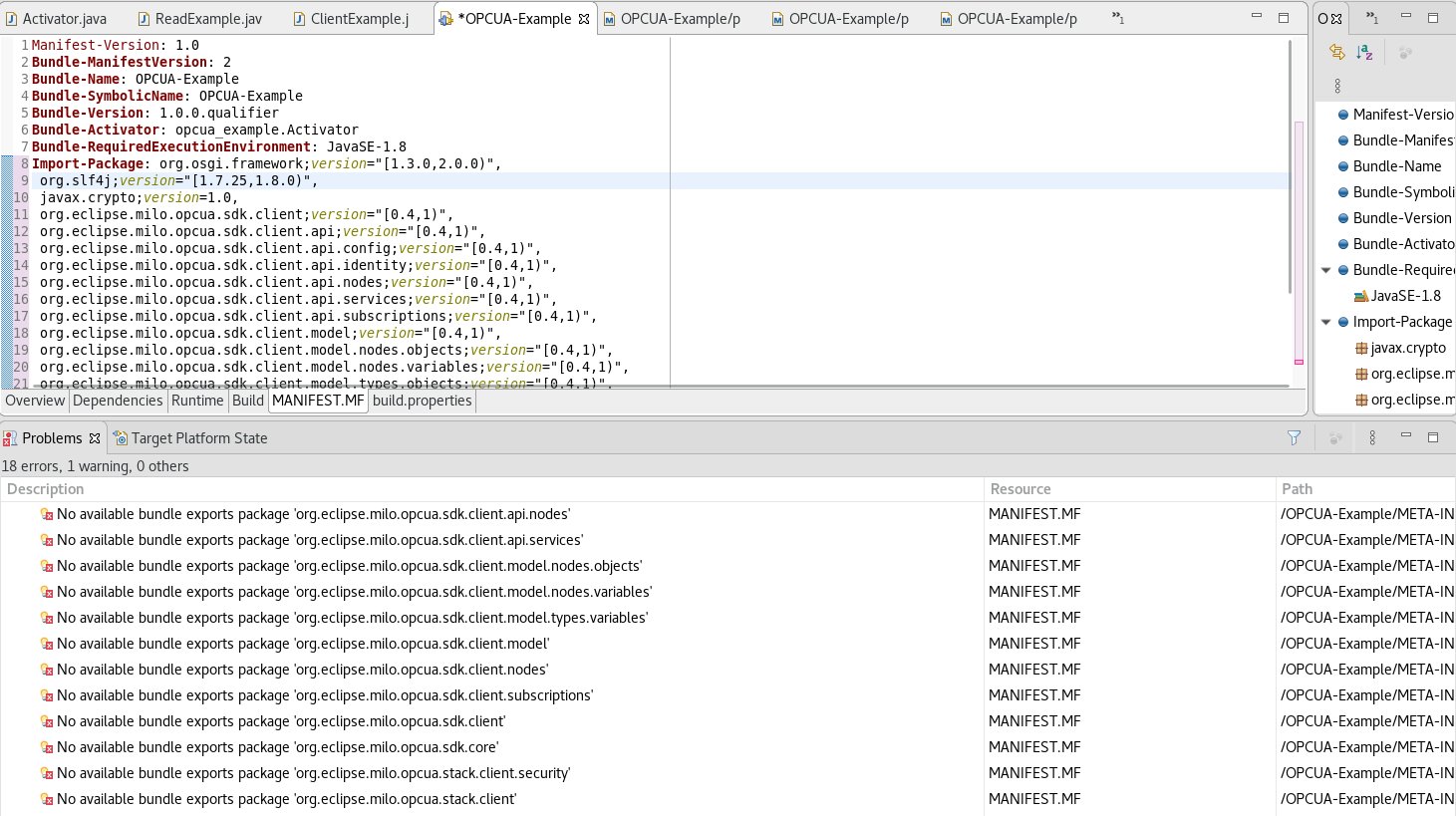

I am trying to make an OSGi bundle of this eclipse milo client examples and run the example as a bundle (eg: ReadExample bundle). So far I have tried different ways but I am not able to set manifest.mf. as we have attached maven dependencies I would like to add plug-in project dependencies. I tried to add but it shows error --> No available bundle exports package 'org.eclipse.milo:sdk-client' MANIFEST.MF /OPCUA-Example/META-INF line 11 Plug-in Problem
I have attached a screenshot for better understanding.
Let me know how to proceed :)

I don't see an attachment. It sounds like you added a package requirement not a bundle requirement...
Re: Eclipse-milo client example [message #1826990 is a reply to message #1826984] Tue, 05 May 2020 15:31 Go to previous messageGo to next message
I have updated the post, I have updated the post.
