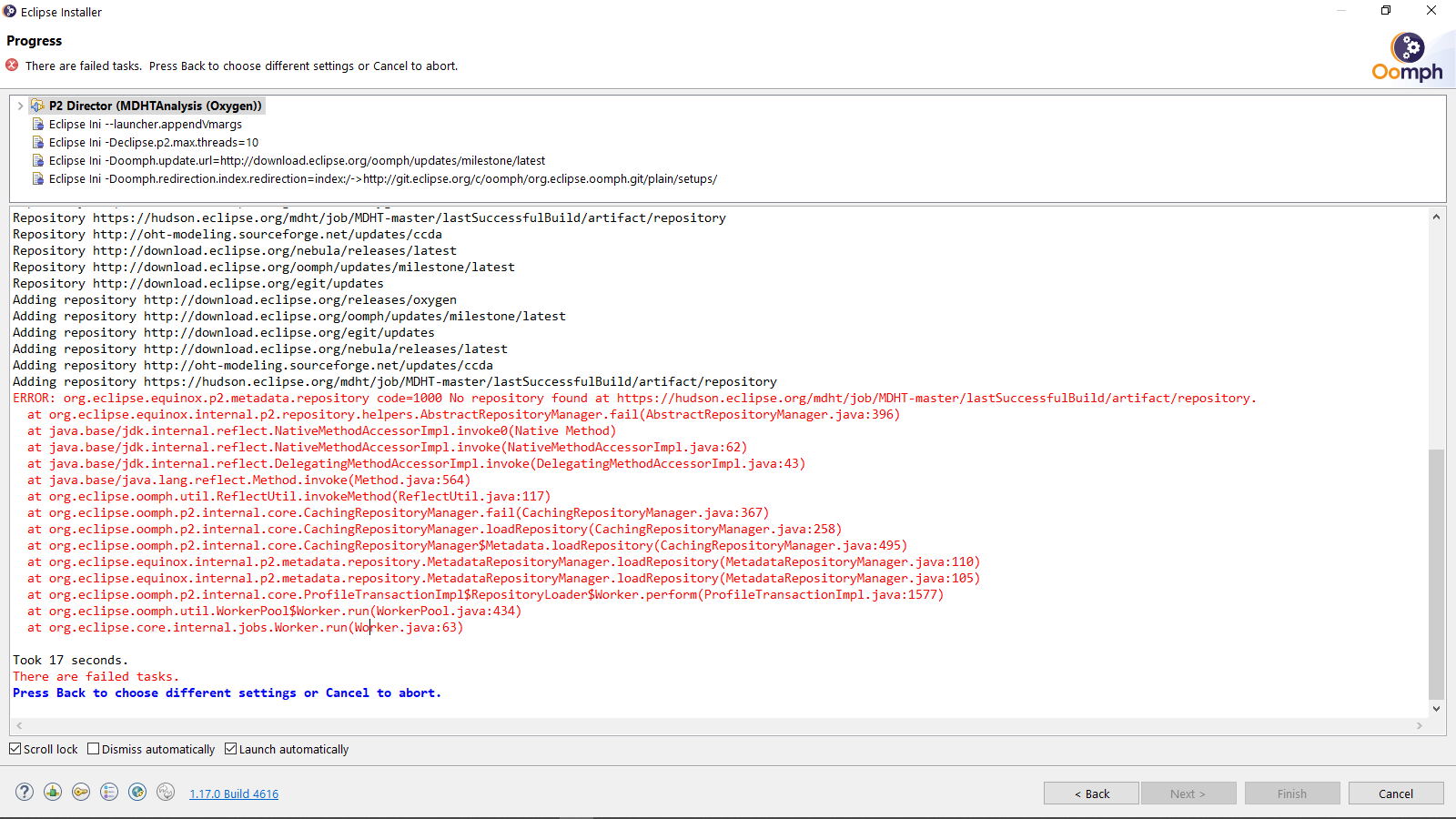

index.php/fa/38040/0/I got this error when installing OxygenMDHT.setup using Eclipse Installer.
Can someone help?

Re: Error when install OxygenMDHT.setup [message #1826979 is a reply to message #1826950] Tue, 05 May 2020 11:01 Go to previous messageGo to next message
Kris -- That is an older setup file - there were changes to the build i will make sure the most updated version is correct sorry for the inconvenience
I did want to confirm your intention when it comes to use MDHT - typically that set up is for someone who is interested in modeling CDA implementation guides
We have other installs for analysts who want to manipulate and validate cda instances
there is also maven support of java developers
which best describes your interest ?
thanks
Sean

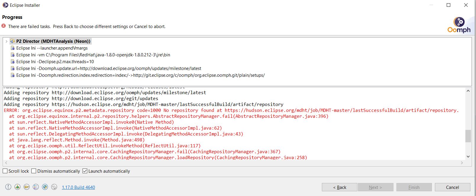

Hi Sean,
I have simmilar problem to Kris (details on the attached screenshot). As I understand I might have an old setup file. Could you please tell me where can I find the new one?
Thanks!
Martin
