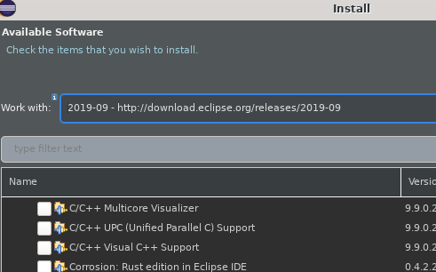

I did this long ago and can't remember what I did.
The Eclipse documentation says all you need is to install Windows SDK.
Under Help-->Install New Software-->Programming Languages there is a selection for Visual C++ Support.
I'm not using currently using Windows so I can't try it myself.
index.php/fa/38059/0/
This thread might help:
https://stackoverflow.com/questions/41401515/visual-studio-toolchain-in-eclipse-for-c
https://stackoverflow.com/a/60646506
