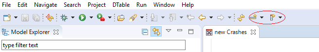

The main toolbar I mentioned is the one with the save button. On a table representation, the "Create line" and "Create Column" from your table description (.odesign file) are added to the main toolbar as you can see circled in red in the attached screenshot.
index.php/fa/38035/0/
Steve
Re: Creating rows and columns in empty table representation [message #1826942 is a reply to message #1826903] Tue, 05 May 2020 00:41 Go to previous message
Great Steve. Many thanks. I did not notice it before.
